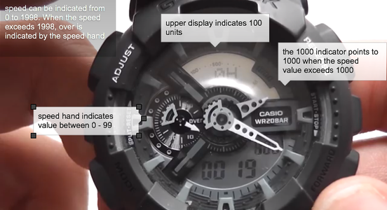

5. speed is indicated in units (which are set by yourself when specifying the distance) per hour on 3 displays of the watch (see picture)
