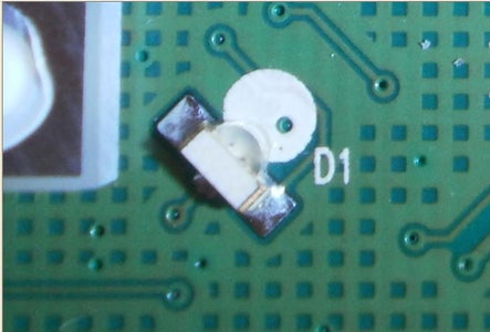

Step 4: Solder
once the wirless card is removed find a way to hold it steady while you solder.take your soldering iron and some solder and fuse the two contacts together.if you want the top two to turn red then (when the xbox is laying down) you solder the two contacts on the D2 LED
if you want all four then solder D1 and D2 this way
note the contacts you want to solder are the one closest one to the top and the middle one
Step 5: All Done
Just wait for the solder to cool then plug the wirless card back into the front and plug in and turn on the xbox just to test. if the lights are red then your done just finish putting every thing back together and invite some friends over the blow their minds.
