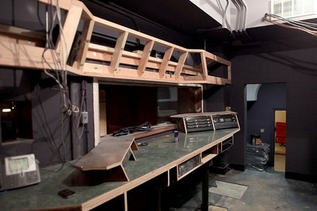

Step 1: Remove the Old Console Desk
Step 2: Recycle the Old Desk and Attach It to the Wall
i opted to have the redesign of the console desk be such that it is floating off the floor,, i will intend to replace the carpet later so all equempment should be elevated.. this also helps keep the equipment cool and mitigates the collection of dust..

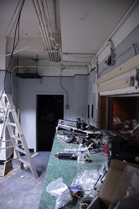

Step 5: Move the Amplifiers
get them off the floor!
they have a new home now,

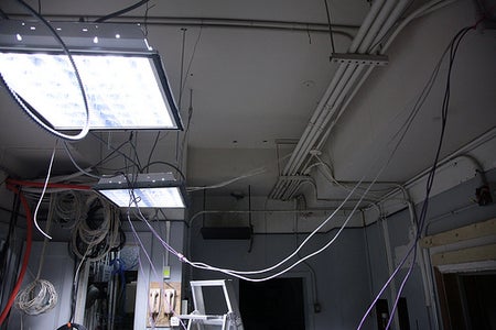

Step 6: Remove the Drop Ceiling? Really?
i was going to have contractors do this but 40 years of throwing cables over to make adhoc connections proved to be to much for the ceiling, as soon as i started poaking around, the mass of cables started to shift and the ceiling started to collapse..
so i started to pull out miles of old microphone cable and got to the real signal cabeling that connected the rest of the building to the soundbooth. the verified cables should be marked then coil up the leads and push them to the wall..
seeing th damage to the old drop acoustic ceiling, i decided to remove it myself and not wait for the contractors... it was a safety issue to start, then i realized i just save some money...

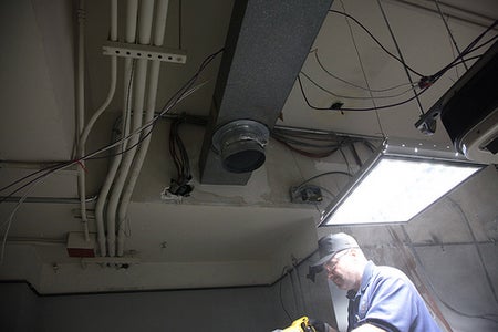

Step 7: Have the HVAC Guys Remove the Air Ducts
they pulled them out and cut them to the walls then added a grate..

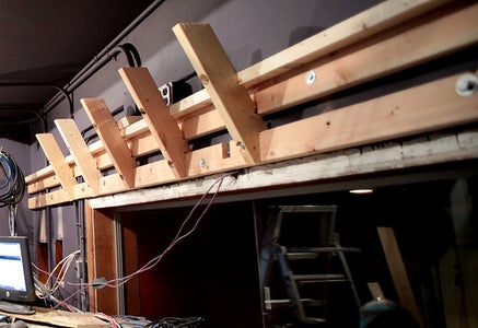

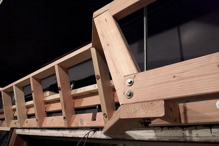

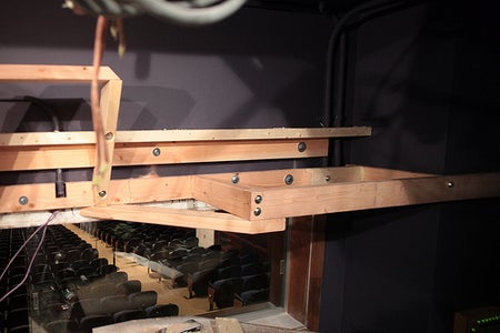

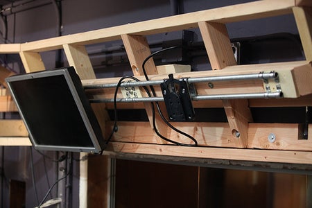

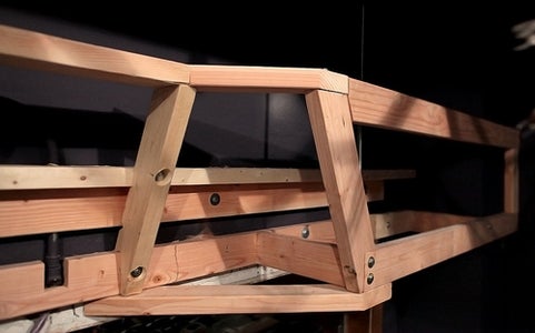

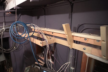

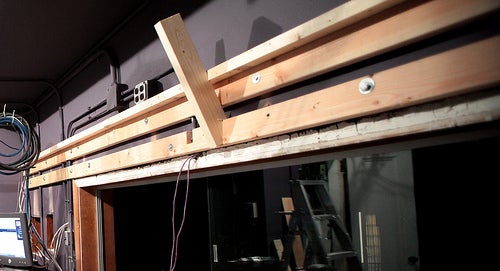

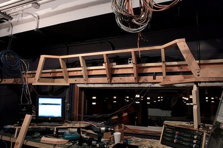

Step 11: Build and Frame Your Hutch
i had carpet comming in on friday and i still hadend even gotten the materials from the carpenters.. it was tuesday!
ugggg!
so i had my director buy the materials and i went in my car to pick them up...
Booo!
the next day i started to frame like a madman!
start by anchoring your anchor boards to the wall with toggle anchors (the walls are masonary)
i tried to get one in every 16 inches or so
when i was sure i had my anchor boards secured well to the wall, i started the build.
ugggg!
Booo!
