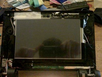

Step 3: And So I Told It Where to Go!!!
this was the hardest and most time consuming part.
and yet ... oh so fun!
the main part to do here is find a place where you can put the controller + hub circuit board.
take a look at the pictures to get the idea, ( the notes on the images are important)
you will want to use tape to hold the wires down.

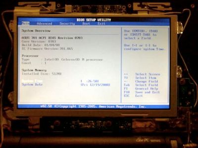

Step 5: Now Get Reddy for Con-fusion!
why do i say that ???
well you see, no matter how hard i tried i could not get it to work.
turns out that for some reason the EEE had decided to disable the web-cam port ( what our gear is now plugged into.)
so i couldn't get it to work for 3 days !!!!
so just make sure that you have turned it on, ( its under " on-board device configuration" in the bios, you get there by pressing f2 at the asus start up screen)
then save and exit, it will restart,
log in to windows.
do a little dance and proceed to the next step!
log in to windows.

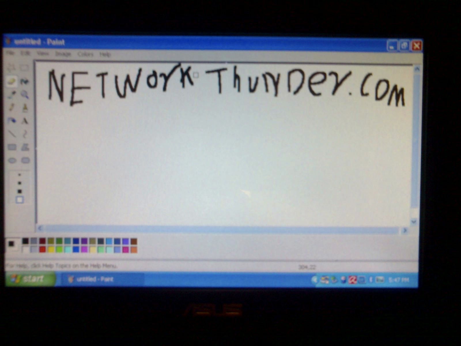

Step 6: Now for the Fun :)
the drivers that i got on the cd for some reason did not work. i have no idea why, but they didn't work, so i went out and downloaded every driver for a touch screen i could find. ( sure i could have asked DX to post me a new driver cd, and they would. but it could take 2 weeks!!)
i went through hundreds of drivers.
but i found the one that works with the touch screen i bought.
i have uploaded the correct driver and i am hosting it my self so that i can guarantee that it works and the link wont die...
All_In_One_2k_XP_Vista_5.0.1.5310_Release.rar
just run through the installer, reboot. then you will have to calibrate the touch panel.
