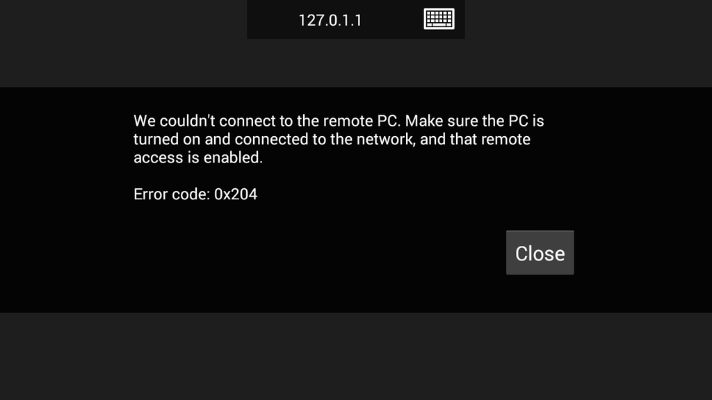

Type hostname -I into lx terminal to find your raspberry pi's IP address. Then in the Remote Desktop fill in your details(Ip address for pi, password for pi,etc) then click connect. It should connect. If not make sure you put in your info right and that the raspberry pi and the kindle are on the same wifi network. You can leave at this but you won't be able to use your kindle+pi anywhere you don't have them on the same network (or offline). If you would like to be able to use it offline continue on with the instructable.

Go into your Remote Desktop app on your kindle and connect to your raspberry pi. If it doesn't work go into lx terminal on your raspberry pi and type in hostname -I again to see if your ip has changed. If so reinsert the ip address in the Remote Desktop and try again.
