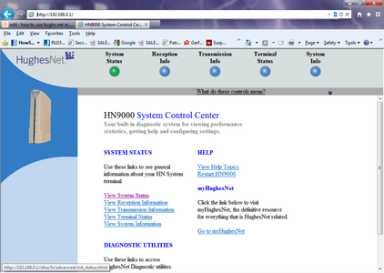

Step 1: Connect to Modem
open your web browser in the address bar type 192.168.0.1 or the I.P address for it if it is different. you will see a home page that has a bunch of links and icons at the top. in the gray bar by what do these controls mean there is a little wizard guy click on the wizard.
next click on diagnostics.
next click on satellite loopback connectivity QOS test
