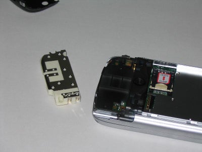

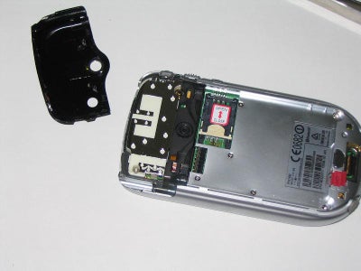

Step 1: Removing the Antenna Cover
Remove the back cover to see the antenna module
Step 2: Antenna
Now you see the antenna module, carefully remove it

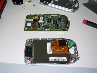

Step 3: Step3
Remove the back screws,then remove the device back.
( note that the gurantee will be violated )

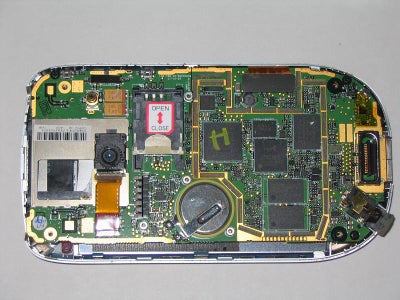

Step 4: Step4
Now you see the main board
( See notes for more information )

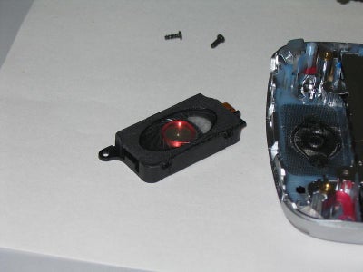

Step 5: Step5
Now the speaker module is removed, it's an example on how to remove any failed component.

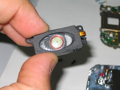

Step 6: Step6
A close view of the removed speaker.
