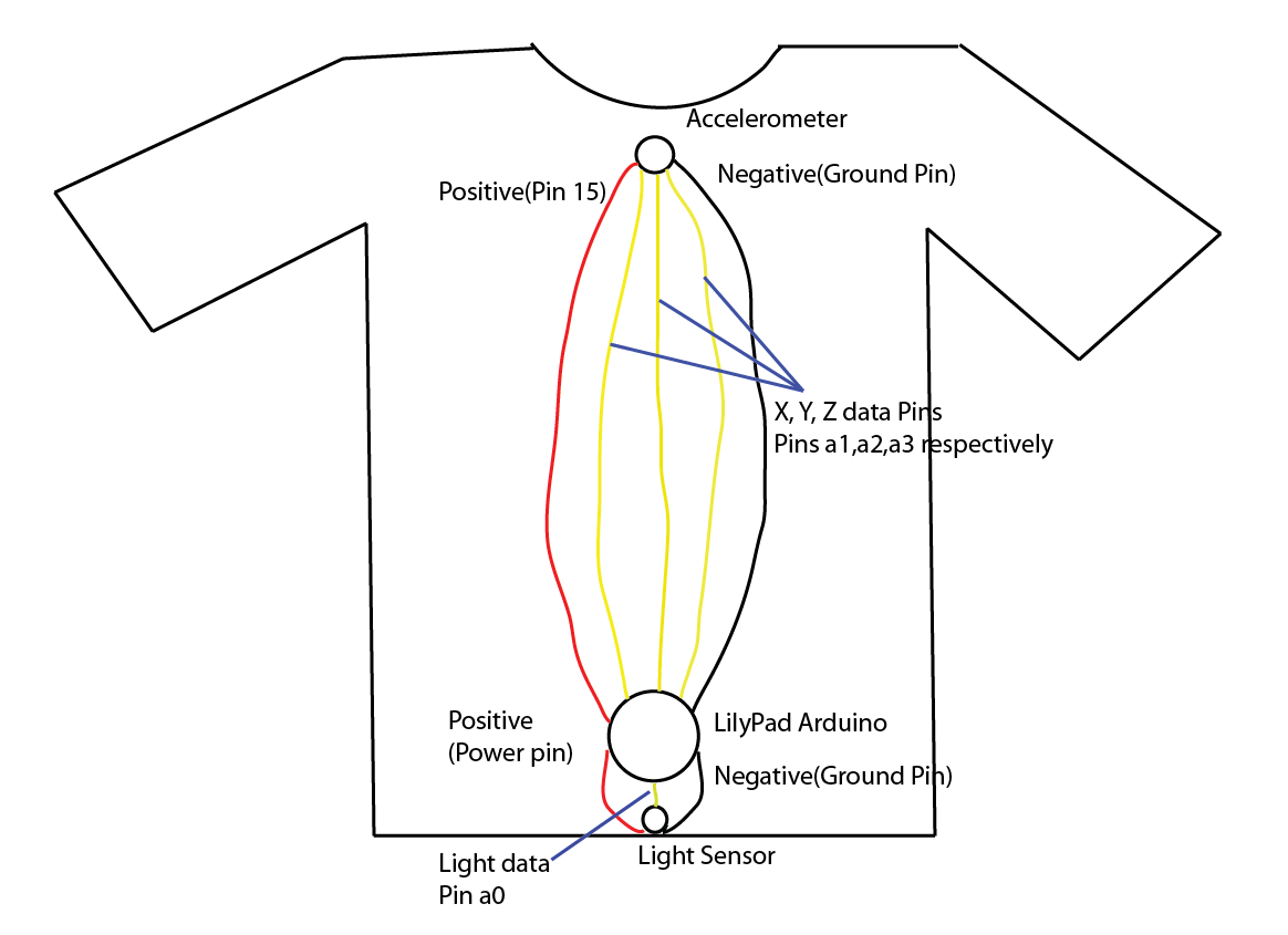

Introduction: IBeat Tee
This was a class project for GEEN 1400 at the University of Colorado-Boulder, Craft Technology Group (www.cs.colorado.edu/~ctg)
The idea behind this idea is to create a new way for a person to express his or her music while on the go. We like to think of this project as the current generation's way of walking around with a boom-box on your shoulder.
The iBeat Tee is standard t-shirt that has a completely removable front panel (meaning that all the electronics are fully removable for washing of the shirt) that lights up according to the beat of music coming directly from the user's MP3 player much in the same way the equalizer does in your media player on your computer.
The iBeat Tee takes input from a user's MP3 player and measures the magnitude of the peaks and troughs of the selected music. We then have written and program that dictates which and how many lights to illuminate on the shirt based off of the magnitudes measured.
The iBeat Tee is designed in a way such that the user can keep his or her MP3 player in his or her pocket while wearing the Tee and so that the user can be using headphones or speakers while the shirt is still in use.
This specific Tee has a cityscape design to it. Feel free to change the design however you wish, though for the purposes of this Instructable the steps will be designed specifically to give guidance on how to build a Tee with a cityscape design.
NOTE: We strongly suggest you look at/do our VU Meter Instructable as we feel it will make this project much easier. Here is the link:

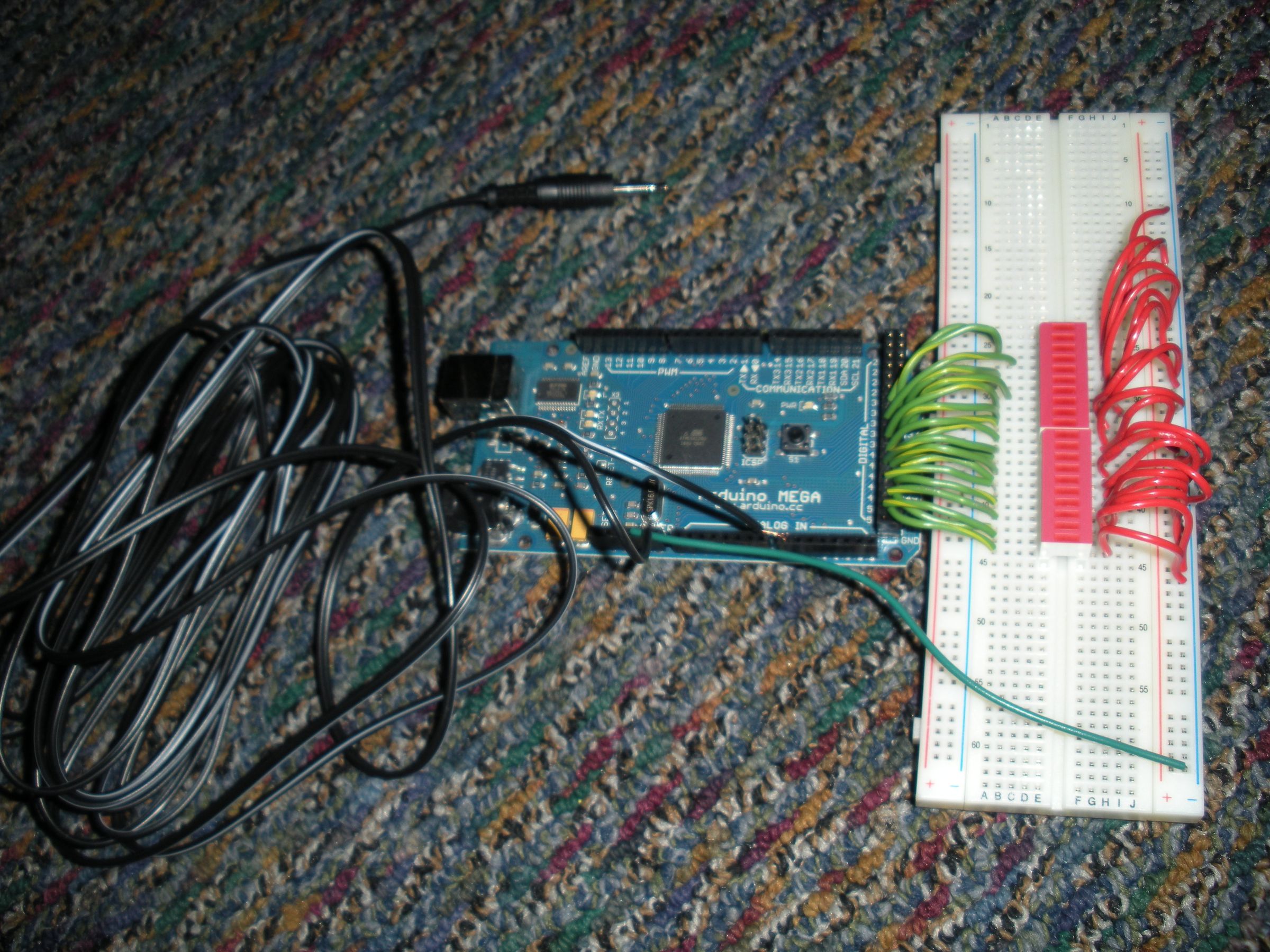

Step 5: Readying the Relay
For this step you will need:
-Two (2) power inverters
-One (1) Relay
-Two (2) 9V snap connectors
The following link is has the specifications for the relay we used and suggest you use:
http://www.crydom.com/en/Products/Catalog/d_o.pdf
NOTE: For EVERY connection made in this step it will be expected that you slip heatshrink onto one of the wires prior to soldering, and then proceed to cover the connection with the heatshrink after soldering.
Solder a lead wire onto each of the pins extruding from the relay.
TIP: Take the lead that you are going to solder to a pin on the relay and wrap it tightly around the solder you are using so it makes a sort of coil. Then pull the solder out and, without undoing the coil, slip the lead onto the relay pin. Since the relay pin is fairly inflexible and is also similar in size to the solder the coil should fit snugly around the relay pin, keeping it steady for you to solder a good connection.
Solder the Positive DC Load pin of the relay to two positive wires of your 9V snap connectors.
NOTE: In this step you will be soldering three (3) wires together: the lead coming from the relay, and the two positive leads coming from the snap connectors.
Next, solder the negative DC Load pin of the relay to the two positive wire from both of the power inverters. NOTE: In this step you once again will be soldering three (3) wires together: the lead coming from the relay, and the two positive leads coming from the power inverters.
Next, solder a short (two (2) inches or so) piece of 22 gauge solid wire to the end of the POSITIVE DC Control pin lead wire of the relay. Leave this wire aside, you will connect this wire in a later step.
