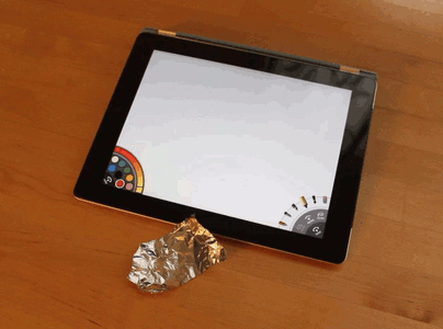

But the capacitive touchscreen doesn’t actually care what is touching it. That means that you can trick the touchscreen into thinking you’re touching it by using a piece of metal (such as aluminum foil) to touch the screen, while you’re touching the other side of it. Go ahead and try it (make sure that the part of the foil touching the screen is about the size of your fingertip).

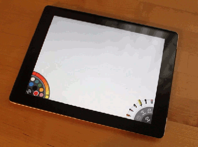

- Drawing: Doodle Paper (Free)

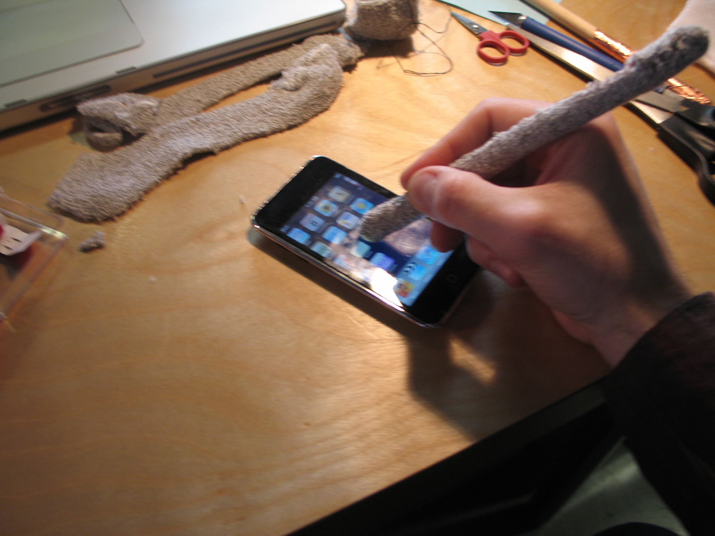

- Wooden knob (just let your fingers touch; a quick DIY version of this fancy knob)
- Foil pencil stylus (foil + pencil = stylus)
- Touchscreen ruler (just use a straight piece of wood as a guide)
- Drawing compass (let the ruler pivot at the end to draw smooth arcs)

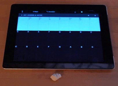

- Sticky tack guide bumps (add some bumps to the screen so you can find buttons without looking)
- Clothespin piano (watch the video)
Start out simple by wrapping some foil around a pencil and learning what works best. Then once you get the hang of it, try different materials and configurations.
