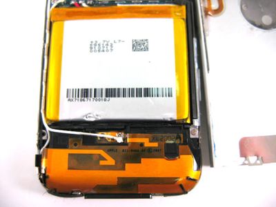

Step 4: Inside the IPhone
Picture 1: Once the sim card is out, you can now free any remaining clips and flip the back case over and lay the two pieces side by side. You now get your first real look at the guts of the iPhone.
Picture 2: Pictured is the battery that is soldered to the logic board, so switching out the batteries are going to be a pain just like on the iPod nanos.

Picture 14: The battery is held on by adhesive to the front case and soldered to the logic board by three wires. It can be gently pryed up from the bottom to loosen the adhesive.
