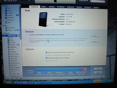

First you need to enable disk use on your iPod. This can be done by :
Hooking-up your iPod to your PC
Opening up iTunes

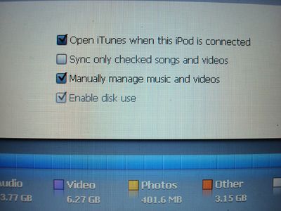

Select your iPod and click the checkbox that says Enable Disk use. (if it isn't already checked)
Click Apply

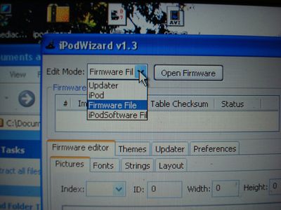

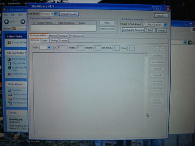

Now in the upper left-hand corner select the drop-down menu next to "Edit Mode", select "Firmware File" and click the "Open Firmware" button.
Navigate to where you saved the Background hack, select the file and click "Open"
After it loads you need to write it to your iPod. It's important to click the button that says "Write" first and when it's done click the button that says "Write to iPod". Click OK for the messages that pop-up.

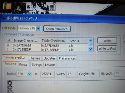

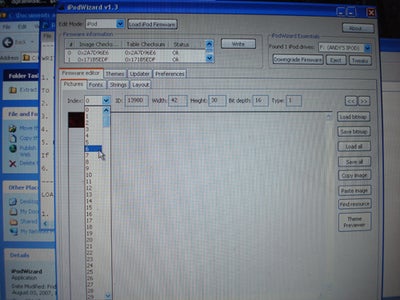

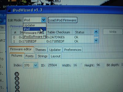

Go back up to the "Edit Mode:" drop-down menu we used before only this time select "iPod" and click "Load iPod Firmware"
When it's done reading, go to the "Firmware Editor" tab, then the "Pictures" tab. Then you click the drop-down menu where it says "Index:", you can scroll through every picture on your iPod.

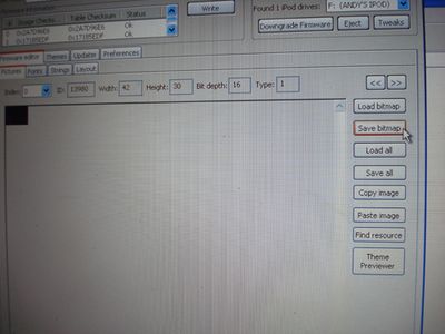

Once you find the picture you want to change, go to the right-hand side of the window and click "Save bitmap". After you save the image (don't change the name), you can open it up in a photo editing program and make the changes you want. Be sure NOT to change the size or file type while your editing it.
If you plan on changing most of the pictures, as most people will, click the "Save all" button in iPodWizard. Since your saving 400+ photos you have to select a folder for them to go to.
After you've made your changes, simply click the "Load bitmap" or "Load all" button depending on wether your loading a single bitmap, or them all and when your done, click the "Write" button at the top and eject your iPod! Make sure if your loading a single bitmap that the image showing is the one you want to change. If you mess up, just click the "Load iPod Firmware" button at the top again, and remake your changes.

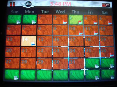

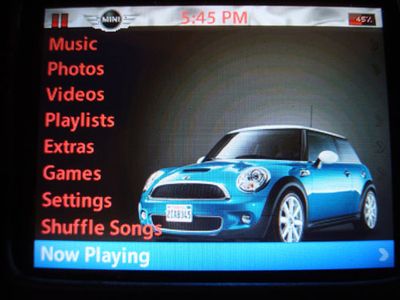

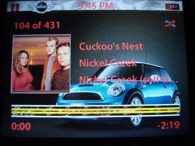

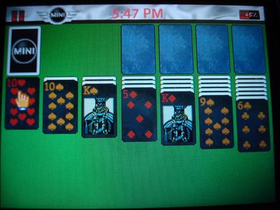

If you don't want to go to all the trouble of making you own theme, you can go to iPodWizard.net to find themes and see the numerous features of iPodWizard. If you like my Mini Cooper S theme, or want anything else as a theme, I'd be happy to send it to you. The ones that have been requested so far are .zip's at the bottom of the page.
