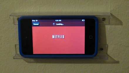

My wife likes to watch something on her iPod before going to bed. To make it easier for her, I made this wall mount which allows her to slide the iPod out for charging.

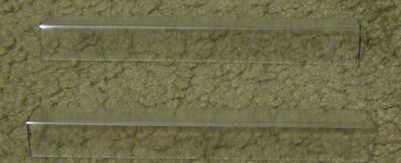

  1. Mark and cut the corner guard into 4 pieces of equal length longer than the iPod.
  2. Sand the ends of cut pieces.
  3. Burn the ends slightly to make them transparent.

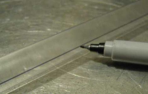

Lay one of the pieces flat and mark it with a sharpie by dragging. Cut it.

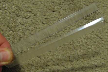

Glue the cut piece to one of the uncut pieces so that it resembles a u-channel using cyanoacrylate (crazy glue). Make sure the smaller piece is on top.

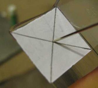

In this step, cut out a square template out of paper and use it to mark corner ends with a sewing pin for drilling.

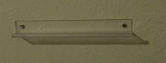

Step 5: Mount 2 Holders
Mount the bottom holder. Remember to use a level. Use the cut piece as a spacer when mounting the top piece.
