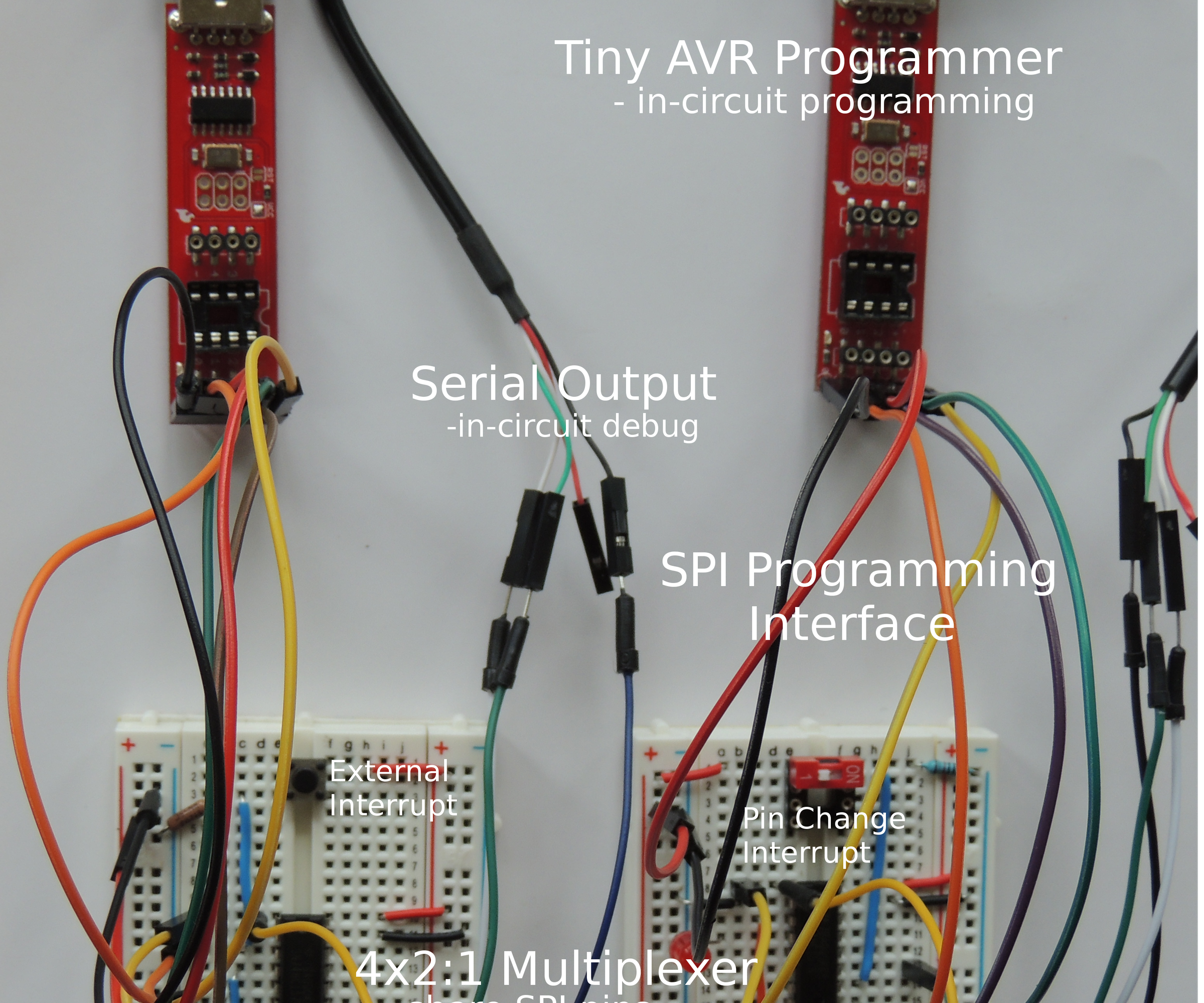

This instructable addresses the debugging issue by describing a method to add serial output to the ATtiny devices. Debugging with print statements is a throwback to the good old days but certainly beats blinking leds and at least puts you on par with development for the UNO, which of course has built-in serial support.
Since serial support requires 2 additional device pins for the transmit and receive signals (leaving the ATtiny85 with NO free pins), the second issue of reuse of the dedicated SPI programming pins becomes even more critical. Because adding a discussion of the pin reuse solution would make this instructable too long, reuse will be addressed in an upcoming follow-up instructable1 which will build on this part 1 setup.

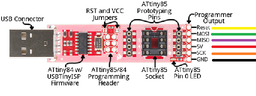

Step 3: Tiny AVR Programmer Setup
The Tiny AVR Programmer has an existing pinout for the SPI interface signals but a 6-pin header must be soldered to the outputs in order to extend the signals to the breadboard.
After soldering, follow the Sparkfun hookup guide to install the required USBtinyISP driver (before plugging in the Programmer to a USB port). To complete Programmer setup, connect jumper wires to the newly soldered header. The signal names and recommended wire colors are shown in the diagram above.
Notice that the Sparkfun Programmer has an onboard socket for ATtiny85 programming. The socket together with the 4-pin access headers on either side allow download and prototyping for the tiny85/45/25. However, this approach is restricted to the tinyx5 devices. On the other hand, the SPI interface allows programming and in-circuit test/debug of most of the ATmega, AT90, and ATtiny microcontrollers. An excellent discussion of application of the SPI interface for programming of AVR microcontrollers can be found here. While this is an application note for use of the Equinox programmer, the conclusions apply equally well to the Tiny AVR Programmer.
Step 4: BreadBoard Layout for ATtiny84
Now populate the breadboard with the hardware components as shown in the fritzing diagram above for the ATtiny84. It’s probably best to orient the components and connections as closely as possible to those in the diagram in order to reduce the risk of connecting an SPI or Serial signal to the wrong pin. (Note that the pin numbers listed in the diagram are the Arduino Pin numbers, not the device physical pin numbers.)
  • All 6 Tiny AVR SPI signal lead wires are connected
    • VCC (red) to the breadboard power rail
    • MOSI (green) to the tiny84 pin 6 (MOSI)
    • MISO (purple) to the tiny84 pin 5 (MISO)
    • RESET (yellow) to the tiny84 pin 11 (RESET)
    • SCK (orange) to the tiny84 pin 4 (SCK)
    • GND (black) to the breadboard ground rail
  • The LED is connected via a 300 ohm resistor to Pin 4 (SCK)
  • A 10K pull-up resistor connects power to RESET
  • Three of the four signals on the USB to Serial cable are connected:
    • Ground (black) to breadboard ground rail
    • Transmit(green) to receive pin assigned to SoftwareSerial (pin9)
    • Receive (white) to transmit pin assigned to SoftwareSerial (pin 10)
    • Power (red) should not be connected since power is being supplied by the Programmer

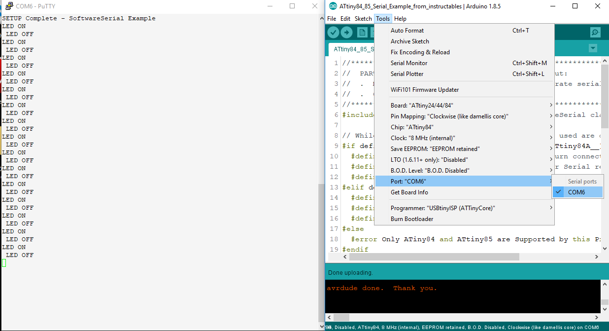

Step 6: Run the Program
Set Board to ATtiny84Set Programmer to USBtinyIsp (ATTinyCore)
The environment is now complete. Follow the steps below to run the program:
  1. Copy the example program into the Arduino IDE
  2. Configure the IDE (as shown above) for the ATtiny84 and compile
    • Board: "ATtiny24/44/84"
    • Pin Mapping: "Clockwise (like damellis core)"
      • this is the default but inadvertently changing it has CATASTROPHIC consequences
    • Chip: "ATtiny84"
    • Programmer: "USBtinyISP (ATTinyCore)"
  3. Plug in the Tiny AVR Programmer to a PC USB port
  4. Plug in the Adafruit USB to TTL Serial cable into a second USB port
    • A COM port is created and will be added to the Arduino IDE Port list
  5. Select the port created in step 4 (COM6 on my system) and launch the COM window
  6. Click the upload program (right arrow) button at the top of the Arduino IDE
  7. The program will be loaded to the microcontroller and start to run
    1. The led blinks on and off at 2 second intervals
    2. The following serial output messages are written to the COM window
      • SETUP Complete - SoftwareSerial Example
      • LED ON
      • LED OFF
      • … led on, led off message sequence repeats in unison with the led blink
