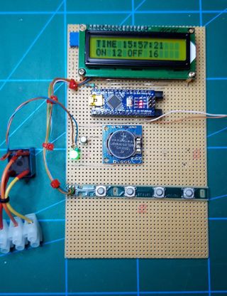

Hi, with this project you will be able to control the on and off of your devices between the time you want. They may be the lights at the night, water the garden, turn on a machine, etc. We will use the arduino, the LCD and the RTC 1307 to show and control the time. You can set the "ON" hour and the "OFF" hour, by 4 push buttons that let you increase or decrease the "SET POINT". Also, you will learn to make a clock with the arduino. I included fritzing schematics and a video, so you can make this project.
First, watch the video to know what is all about. Use it like a guide

Step 3: Setting the Time
Now we have to set the clock. Run the code "Set time RTC". This sketch take the Date and Time according the computer you're using (right when you compile the code) and uses that to program the RTC. If your computer time is not set right you should fix that first. Then you must press the Upload button to compile and then immediately upload.
Warning !: If you compile and then upload later, the clock will be off by that amount of time.
Then open up the Serial monitor window to show that the time has been set
Step 4: The Clock
With the time set, open and upload the sketch "Clock with RTC LCD" . The 10K trimpot is for the lcd contrast.Turn it to adjust the contrast and see the numbers clearly.
If everything works fine, you will have the clock running. See the video.
Step 5: Mounting the Timer
Now we add the push buttons and the relay. Follow the fritzing schematic.
So, you have pins 8, 9, 10 and 11 connected to gnd by 10K resistor(LOW). When you push, it will be connected to 5V (HIGH).
The relay is connected to pin 12. With the relay you can control your devices. Be careful with the maximun load of the relay!
Step 6: The Timer
Open and upload the code "Timer with on off set point" . You will see the current time, the "ON" set point and the "OFF" set point. The default "ON" and "OFF" time is 12.
The timer runs from 0 to 23 hours, and so on. Push the buttons to change the set point up and down. The timer will start immediately if it is between the setting values.If not, will wait to the "ON" hour.

quick question, Can I use the RTC 1307 at24c34 without having to modify the code? I can get them real cheep local but nobody has the RTC 1307 without the memory. I have looked at your other timer version using the DS3231which I love also, but my application only needs 1 cycle per day on for 3 hours and off until the next day same time again so this is perfect. I see Marielle. Magbaua made the time with the at24c34 I can tell from her picture. Just need to know if the code stays the same. Thanks and great work
0
Tobiasmx
Tobiasmx
Answer 5 months ago
update: RTC 1307 ar24c34 works fine no issues.

rocky4ritesh
rocky4ritesh
1 year ago
sir can we replace rtc1307 to any other like ds3231
if yes show me the connection
0
NicolasJ7
NicolasJ7
Reply 1 year ago
Yes, you can. Look at the rtc library and set the time. Then you have to change the variables ( like RTC instead of rtc). Watch my other timer with the 3231, link in the intro.
