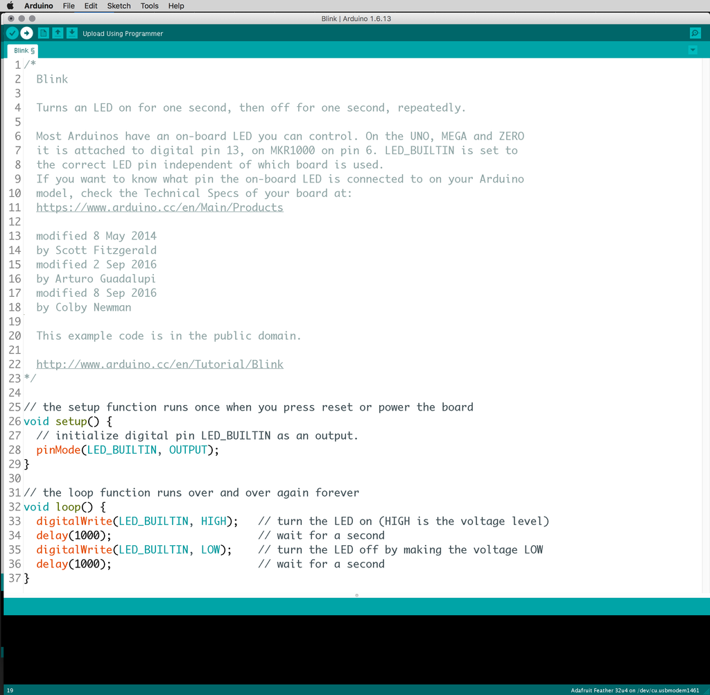

As with all microcontroller projects, be sure you're able to program the Blink sample code to your board before proceeding. Open the sketch from File->Examples->01.Basics->Blink, or copy the following into an empty sketch:
void setup() { // initialize digital pin LED_BUILTIN as an output. pinMode(LED_BUILTIN, OUTPUT); } void loop() { digitalWrite(LED_BUILTIN, HIGH); // turn the LED on (HIGH is the voltage level) delay(1000); // wait for a second digitalWrite(LED_BUILTIN, LOW); // turn the LED off by making the voltage LOW delay(1000); // wait for a second }

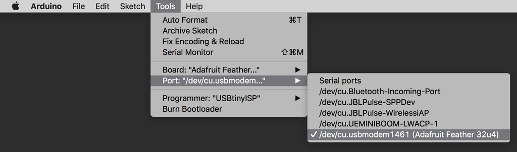

Under Tools->Board:, select Adafruit Feather 32u4. After plugging in your Feather Bluefruit, you should see it appear under Tools->Port:. If none of your ports are labeled, try unplugging your board, checking
the Ports menu, then replugging your board and checking the Ports menu again. Whichever port name disappears then reappears is likely to be your Arduino board. On Windows your port will likely be called "COM3" (or higher numbers) and on OS X it's likely to be something like "/dev/cu.usbmodem1461" (with different numbers in place of those shown).
Now click the Upload button (right-facing arrow) to transfer the Blink example code to the Arduino board.
