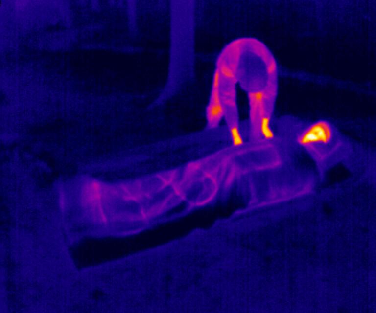

Carbon is the most efficient radiator of heat. A significant part of the energy emitted in the infrared range and penetrates deep into 4-5 cm of the human body. This warms the body evenly and retained an intense blood flow for a long time, as after a good massage.
Carbon fiber is breathable, so your elbow does not sweat and you will feel comfortable.
Carbon rope isn't afraid of high temperature and has an unlimited period of work, but electric wire at a high temperature is rapidly oxidized by atmospheric oxygen, electrical contact will broken and got very hot. To make a reliable contact is necessary to isolate it from the oxygen with an adhesive. Since the adhesive certainly get between terminals, it must be electrically conductive adhesive. The best is silver glue.
As you can see, the contact place with a silver adhesive is cold and contact without silver greatly overheated.
