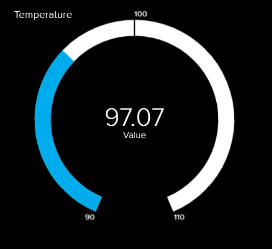

  • 4. Data can be visualized from a graph

Dashboard Graph from Adafruit.io
Gauge view
