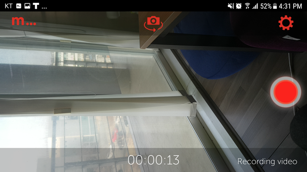

Step 5: TURN YOUR OLD SMARTPHONE IN a WEBCAM WITH MANYTHING
ManyThings is a web service that allows you to turn any smartphone or tablet into a smart camera by simply adding their app. You can also see a live stream and record particular moments when motion is detected, and since it is free for one camera, it’s a perfect service for our project!
Any phone that let you install this app can be used, and if it even has a frontal camera, you can make it film both sides, which is a great way to recycle your old smartphone!
  • Download the app on iOS or PlayStore depending on the smartphone you will use as a webcam.
  • Sign up and choose “Camera” to put it in Webcam mode (Viewer is the mode to use on the device from which you want to monitor).
Your phone will switch to camera mode and as soon as you press the red button it will start recording and live streaming.
  • Go to manything.com or open the app on another device to monitor what is happening
  • Have a look at the settings to define the threshold of motion (from 1 to 10), the notification and recording parameters and the detection area.
