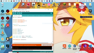

hey so everytime i try to upload i get this message
Arduino: 1.8.5 (Windows 10), Board: "NodeMCU 1.0 (ESP-12E Module), 80 MHz, Serial, 115200, 4M (3M SPIFFS)"
C:\Users\Twentytwo\AppData\Local\Temp\Temp1_esp8266_deauther-master (1).zip\esp8266_deauther-master\esp8266_deauther\esp8266_deauther.ino:11:17: fatal error: oui.h: No such file or directory
#include "oui.h"
compilation terminated.
exit status 1
Error compiling for board NodeMCU 1.0 (ESP-12E Module).
This report would have more information with
"Show verbose output during compilation"
option enabled in File -> Preferences.

I have this same problem
0
tytower
tytower
Reply 1 year ago
Search for this in Github . Go to issues and its stuck at the top
