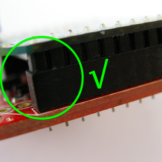

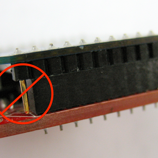

Insert the XBee3 Cellular into the XBIB development board or your XBee USB adapter, being careful to align it so all the pins are in the socket correctly, as shown in the photos.
Assemble the XBee3 Cellular hardware and connect to your computer. Be sure to use the 12-volt power supply because USB alone does not provide enough current to properly operate the module. The kit comes with a free limited-use SIM card. You can also purchase your own from a vendor like AT&T or Twilio.

  1. Remove the XBee3 from the XBIB development board, pulling it straight up and being careful not to bend the pins. If you do bend any, carefully straighten them before moving on.
