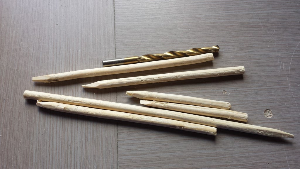

When you disassemble a pallet it happens that the ends get cracks especially when you use brute force like I do. You can cut of the cracked part and use it to make a fire or you can reclaim your reclaimed board to make dowels. We will use the dowels in step 4, so hang on!
There are many techniques to make dowels but the easiest is to hammer a piece of wood through a hole. I drilled two holes in a L-shaped iron scrap and clamped it in my bench vise.
I first used a crafts knife to pre shape the wood and made a sharp point to one end. This will make it easier to hammer it through the first big (10mm) hole.
Then I smashed the 10mm dowel (yes it's a dowel already :-) through the smaller hole to get a 6mm dowel. I also kept two 10mm dowels (15 cm long) to attach the handle to our beer holder.
Next I sanded the dowels to make them smoother. They ended up not that straight but I was happy with them and figured it was time to proceed with the next step.

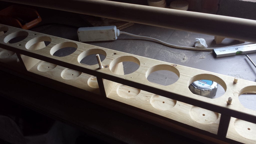

I first applied a good amount of glue to the joints and aligned them (on sight) on the top board.
I used the dividing lines as a guide to drill pilot holes 15mm from both edges.
I added temporary wood screws to clamp the pieces together. (don't you dare to look at my belly button!)
Note: do the same for the bottom and side boards. Every joint must be glued and clamped with two wood screws.
Step 4: Replace Screws With Dowels
Once the glue was set I removed all the screws and drilled 6mm pilot holes for the dowels (joint after joint).
Add enough wood glue and wipe of the excess after hammering the dowel in the pilot hole.
I used an iron saw to cut of the dowels and then sanded them flush with the board.
The handle is secured with a long 10mm (diameter) dowel at both sides. I also smashed in a small nail to reduce the rotational stress on the glue.
