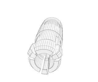

To challenge here was to make sure the penholder touches the paper while the penholder is supporting the pen. I made measurements of the the Cricut penholder and of the Circuit Scribe pen with a caliper.
I started modeling in Tinkercad because it's easy and free.
Pretty basic stuff: start with a cylinder the size of the penholder, draw another cylinder with size of the pen, an opening at the top and some cutouts to make sure it's tight. You can find the result here: https://tinkercad.com/things/0rWMscQIeUI
After that I wanted to fine-tune the measurements to make it fit better and while it's possible to do it in Tinkercad I recreated the model in Modo because it's easier to do detailed modifications when you have sub selection (vertices, edges and polygons) available.
The little legs that help tighten the holder break off easily, so careful with that.
