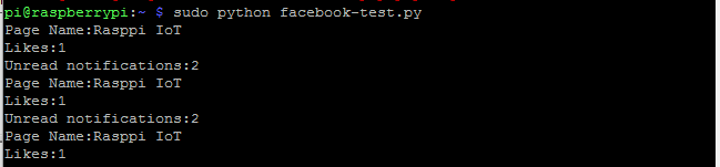

Transfer the file to Raspberry pi and run it using the command:
sudo python facebook-test.py
If everything works well you will get output like following.

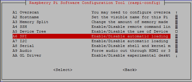

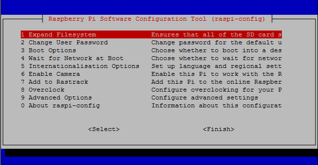

We have completed connection. Now, lets enable SPI interface of Raspberry Pi. To do this,
1. Open terminal and type:
sudo raspi-config
A configuration window will appear like below.
2. Press down arrow key and select Advanced Options & click Enter.
3. Select SPI and click Enter

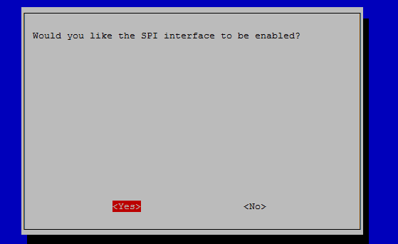

4. It will ask for confirmation, just press Enter to yes.

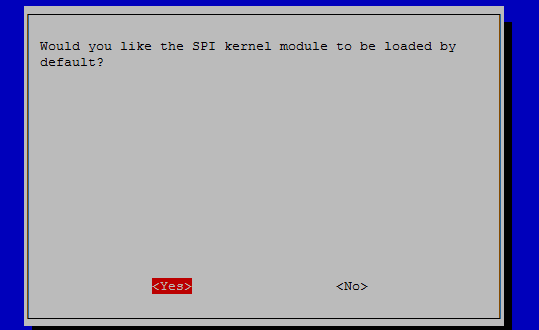

5. After confirming a new window will appear asking you like to load kernel default or not. Select yes.
5. You may ask to restart your Pi. Restart it. Now your SPI interface is enable.
