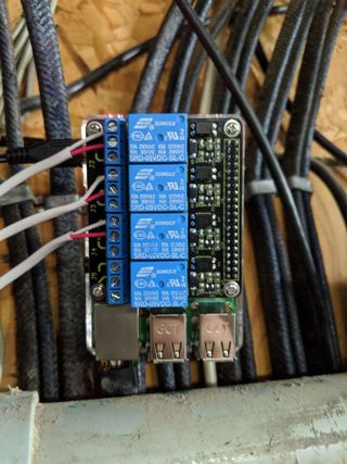

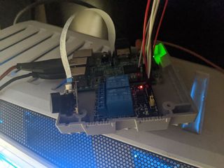

Step 5: Wire the Circuit to the Pi!
Now for the fun part - we wire the relay to the pi! For the code I provided (step 4 and 6) I used GPIO pin 7. You can use whichever one you want, but be sure to change the code.
Below is a diagram and my wired pi mounted on cardboard with zip ties. I used an old floppy disk ribbon cable for easy testing of ports and just left it connected.

Step 7: Attach Raspberry Pi to the Garage
This part is very easy. Just follow the wires of the button attached to your garage motor and attach the relay the same way. Since the relay isolates the circuit, the direction doesn't even matter.
And you're done! Let me know it works for you.

Thanks for the excellent documentation and instructions. I made this yesterday using a Raspberry Pi 3, but I am now thinking of modifying the set-up to use a Pi Zero W, since this set-up really doesn't require much horsepower. Has anyone else done that?
I also modified the overall set-up a little bit by setting up a static ip using port forwarding on my Google WiFi and the no-ip service so that I can access the opener from anywhere. I have a Smart Things hub at my house, so I can sense whether the garage is open or closed, then I can use this RasPi set-up to open or close it when I want to.
