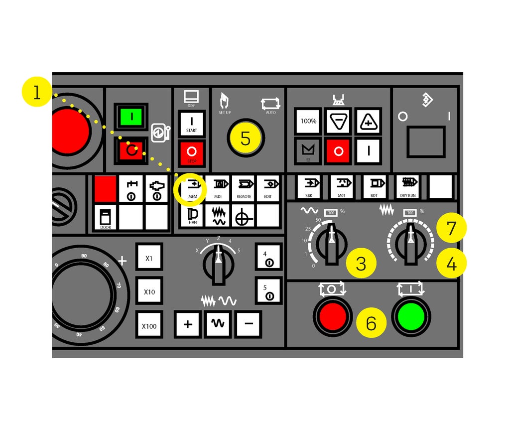

Step 1: Run Program
RUN PROGRAM
  1. Press MEM.
  2. Highlight program in Data Server.
    • Data Server is under Running/Program Manager.
  3. Select OPEN
  4. Turn Rapid Rate to 10%.
  5. Turn Feed Rate to 0%.
    • When Feed Rate is 0%, neither the spindle nor the trunnion will move, even for rapid moves.
  6. Switch key to AUTO.
  7. Press CYCLE START.

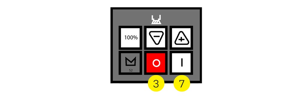

Inspecting part during program
  • If you need to inspect your part mid-program, you must turn off the spindle before opening the door.
  1. Press FEED HOLD.
  2. Press HAN.
  3. Turn spindle off.
  4. Turn coolant off.
  5. Press Door Unlock.
  6. Open door, check part, and close door. 7. Turn spindle on.
  7. Press MEM.
  8. Turn coolant on.
  9. Press CYCLE START.
