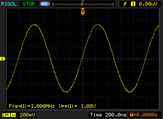

To demonstrate that issue I set my resistance box to 50 Ω, while I had it in series with my signal generator which also has a 50 Ω output impedance, and I measured the peak to peak voltage while the frequency was at 1 Khz, 10 Khz, 100 Khz, 1 Mhz, 10 Mhz and 20 Mhz.
On my signal generator I also set the amplitude of the signal to be exactly 2 Vp-p, so, since we basically have two 50 Ω "resistors" in series forming a voltage divider, we would normally expect to see 1 Vp-p across the resistance box regardless the frequency of the signal.
But, since our resistance box is not perfect and it has an amount of parasitic inductance as we are going to see that's not actually going to be the case.
On the image below you can see the signal across the resistance box while its frequency is at 1 Khz:
Here while it is at 10 Khz:
Here while it is at 100 Khz:
And finally, here while it is at 1 Mhz:
As we see, the signal on all those frequencies is about 1 Vp-p, exactly as we expected it to be. But see what happens when we increase the frequency to 10 Mhz:
As you can see, the amplitude of the signal has started to increase, let's increase the frequency a little more, to 20 Mhz:
As you can see, the amplitude is now about 1.5 Vp-p instead of the theoretical 1 Vp-p. Since the output impedance of the signal generator is fixed at 50 Ω, this can only mean that the resistance of the resistance box has been increased by roughly 100 Ω!
And that makes sense, because if we calculate the inductive reactance of the parasitic inductance, which we have already measured to be about 812 nH, at 20 Mhz we get,
that it is about 102 Ω.
That means instead of just the 50 Ω resistance of the resistance box we also have an additional 102 Ω in series which comes from the parasitic inductance. So, using the voltage divider formula we can calculate that the voltage across our resistance box is going to be,
roughly 1.5 Vp-p, which gets validated from our measurement.

Another thing we saw was the presence of parasitic inductance, which at lower resistance ranges as I demonstrated starts to gradually become an issue as the frequency of the signal rises above 1 Mhz. As I already explained, the parasitic inductance acts like an extra frequency dependent resistor in series with the resistance box, which can increase the error above 1% on the lower resistance ranges if the frequency is high enough.
From my tests I came into the conclusion that the major contributors to that parasitic inductance were the decade encoders themselves. So, an easy and simple fix would be to just add a switch that would short the 1 KΩ and above ranges, in case you want to work with low resistances at high frequencies.
That way you would just have the parasitic inductance of only three decade encoders instead of eight, which is going to reduce the total parasitic inductance by several hundreds of nH. And as a good side effect, this should also reduce the resistance offset, since now you'll have the resistance of only three encoders in series, so I think it would definitely worth the shot.
