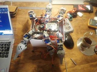

This is all electronic schematic, basically all servos controlled by 32CH servo controller because it's already have micro controller in it. Just like arduino it's independence and can controlled using serial command from PS2 controller, PC or other device.

Cabling mapping :
  1. 5v power out (+) from UBEC
  2. Ground from UBEC and Mini Stepdown
  3. 5v power out (+) from mini step down
  4. to Wemos D1 mini G pin
  5. to Wemos D1 mini 5v pin
  6. to Wemos D1 mini RX pin
  7. to Wemos D1 mini TX pin
  8. (match the pin color with the servo cable color) to right front leg (pin 1 to coxa, pin 2 to femur, pin 3 tibia servo)
  9. (match the pin color with the servo cable color) to left front leg (pin 5 to coxa, pin 6 to femur, pin 7 tibia servo)
  10. (match the pin color with the servo cable color) pin 9 to claw servos (assemble the claw first)
  11. (match the pin color with the servo cable color) to left middle leg (pin 13 to coxa, pin 14 to femur, pin 15 tibia servo)
  12. (match the pin color with the servo cable color) to right middle leg (pin 17 to coxa, pin 18 to femur, pin 19 tibia servo)
  13. (match the pin color with the servo cable color) to left back leg (pin 25 to coxa, pin 26 to femur, pin 27 tibia servo)
  14. (match the pin color with the servo cable color) to right back leg (pin 29 to coxa, pin 30 to femur, pin 31 tibia servo)

Step 6: Initial Pose
IMPORTANT...!!
we need to set the initial pose for the spider.
  1. turn on the robot (at the first time maybe all the leg will be miss pose so for this step please release all the servo horn first)
  2. reattach the servo horn and adjust the coca, tibia and femur pose just like the picture abbove
  3. turn off and turn on again to make sure that all leg is in the right position

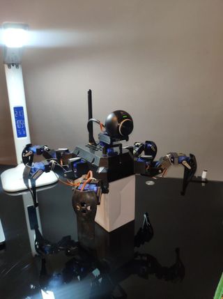

I created a remix version with a camera and all the code is in python on a raspberry pi zero w
PS : for all those who have a freeze problem, this comes from the driver card, you have taken the Chinese version USC 7.7 which does not work with speeds higher than 9600 bauds (this is the one I use in the video)
I can share my python code as well as the 3D plans for the camera if it interests people
I also created a software in C # allowing to control the servos with the Chinese driver card usc 7.70, I can also send you the code sources
there are still slight bugs to fix but please be indulgent I am a student I am not the level of mrusaW
