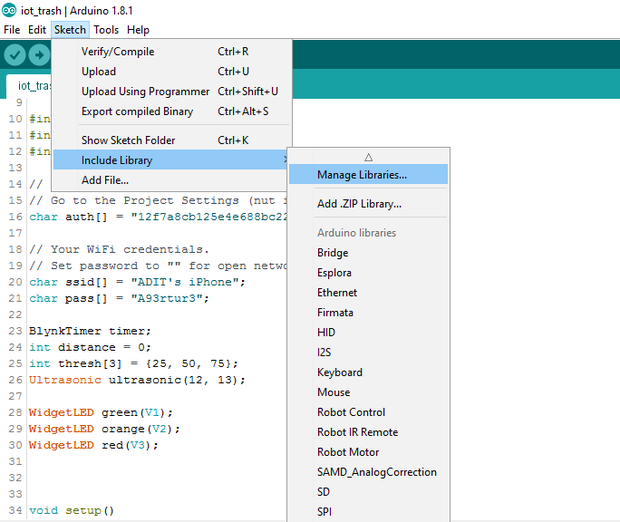

Once your drivers are installed, go ahead and download the libraries needed. For our program to run we need the WiFi101 library, the blynk library and the ultrasonic library, both can be found in arduino's in built library manager. Open to sketch then include library then library manager.
Nowin the search bar, search for wifi101, blynk and ultrasonic, choose your IDE version and install. (double check with the pictures below)
