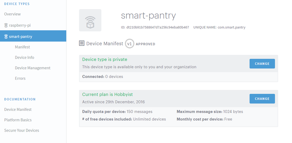

9. After activating manifest you will observe following information about your created device. You just created a new device and now you have to connect the device to your account. To connect the device follow the next steps.

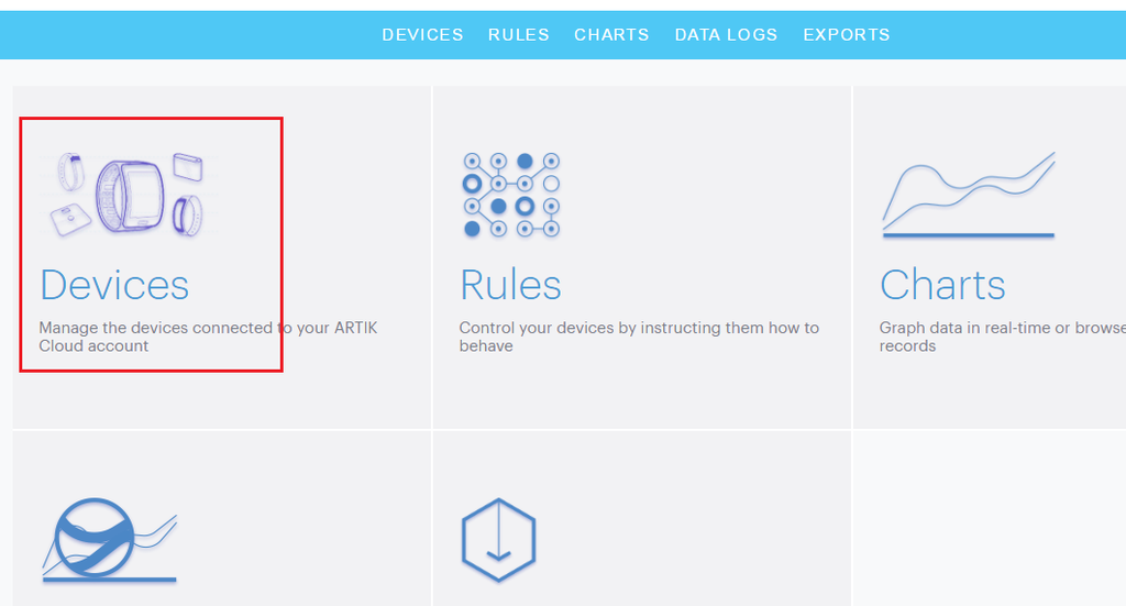

10. From your cloud account, click on Devices
11. Click to Add Another Device. This interface may different in your case as it is the first time you are connecting a device. I already connected a deice named raspberry-pi.

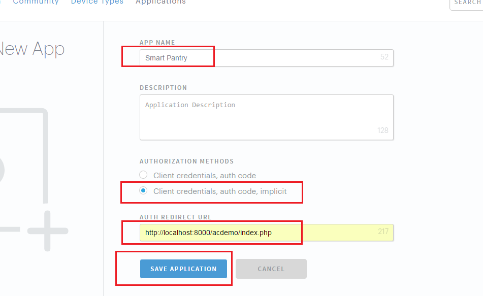

Step 8: Create an Application to Artik Cloud
Before going to develop an Android application we will be required to create an application to Artik cloud. After creating an application we will get a client id which will be used to read data from artik cloud using Android app.So, let's create an application in artik cloud. Login to artik cloud and follow the steps below.
1. From the developer console select Application.
2. Click on NEW APPLICATION
3. Give an APP NAME. Description section is optional. Fill another options according as image and click to SAVE APPLICATION.

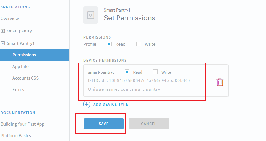

4. Select Read from PERMISSION. Type your device name into DEVICE PERMISSION box and select your device.
5. Set Read permission for your device and then click to SAVE.
6. To get client id click on SHOW CLIENT ID & SECRET button. Client id is important and will be required at the time of android app development.
7. Note your client ID from the Client ID & Secret window.
