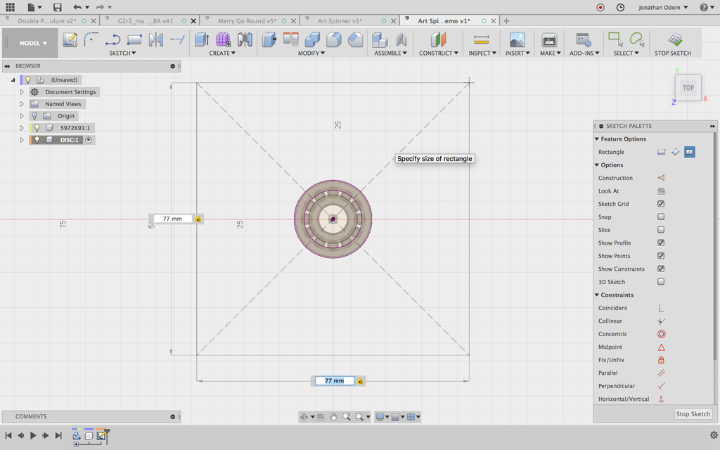

Next, go to Sketch > Rectangle > Center Rectangle. There are three kinds of rectangles you can choose from, but this one will allow us to make one that’s centered on the bearing.
Click on the center point of the circle (origin point of the model) then enter 77mm for both the length and the width of the rectangle. You can switch between the dimensions by hitting Tab. This dimension is the size of a post-it-note. In my case, the 3-inch square ones come out to about 77mm.

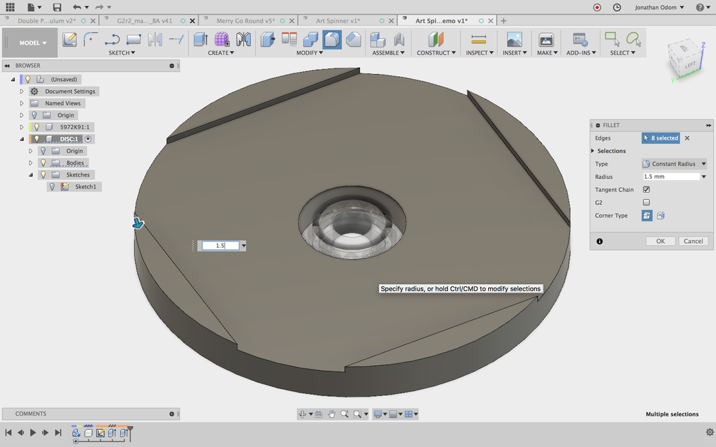

Sharp corners are almost always a bad idea with any object that’s going to be handheld, so I go to Modify > Fillet, then select the vertical edges of the ledges. These are acute angles, so you’ll only need a diameter of 1.5mm at most if you followed the dimensions I used.

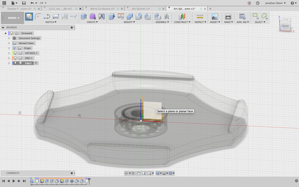

The simple disc shape will work just fine, but I find it a bit boring. To adjust the shape, create a new Sketch using the top face of the disc as the sketch plane.
Draw a Circle from the center of the drawing tangent to the inside edge of one of the ledges.
Draw a circle of arbitrary diameter somewhere outside the main body. Go to Sketch Pallette (right side of the canvas) > Constraints > Tangent, then click on the circle followed by the arc on the side of one ledge, then the circle followed by the arc on the side of the adjacent ledge, then the circle followed by the inner circle. This will give you a closed profile you can use to cut out part of the body.
Create > Extrude this closed profile.
, then use the Create > Pattern > Circular Pattern tool. Note that there will now be the main football shaped profile, but there will also be two small crescent shaped profiles on each end where the circle is tangent to the circles on the sides of the ledges. Select the new curved face and the two smaller faces, then choose the center vertical axis of the model as the Axis of rotation. Make sure the number is set to 4.
To make sure all the spinning edges are smooth, use the Fillet tool again to round off the top edges of the four ledges. The radius should be small here to leave some vertical wall surface to hold onto the post-it note.

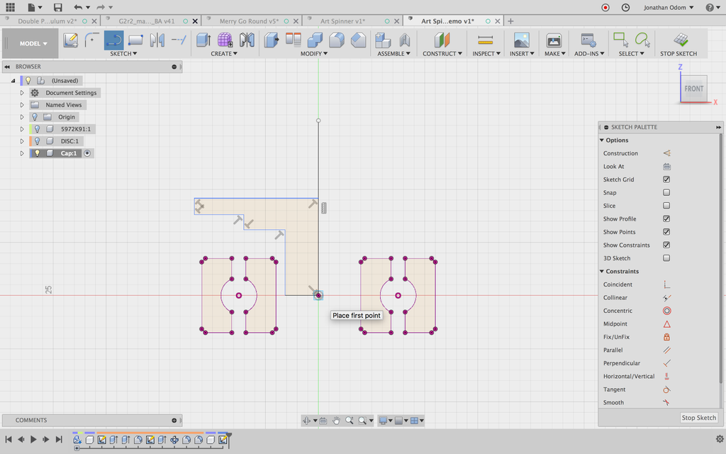

Activate the Top Level Component (the first item in the Browser), then Assemble > Create New Component.
Create a Sketch in one of the vertical origin planes. Go to Sketch > Project / Include > Intersect, make sure Selection Filter is set to Bodies, then click on both the inner and outer rings of the bearing component. This will give you two profiles to work from to create the cap.
We’re going to Revolve the shape of the cap since it has axial symmetry (like a candlestick), so we’ll start with a Sketch > Line centerline going vertical from the origin point of the model. Next, draw a rough shape of what the cap should look like. It’s going to be a shelf with a step below it- this shape will allow the cap to spin without rubbing up against the outer ring, since the inner and outer rings move independently.

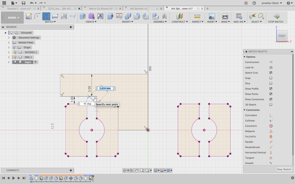

Using Sketch Palette > Constraint > Coincident, click on each of the lines followed by a point on the projected lines until you get a shape that is roughly aligned to the different features of the bearing.
The Sketch > Sketch Dimension tool will allow you to set thicknesses and offsets from the bearing. I’ve got the main cap thickness set to 3mm and the offset of the shelf at 1mm. From experience, these dimensions work well.

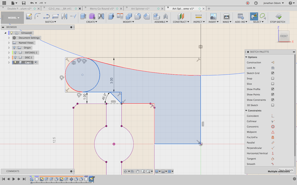

This profile would work as-is, but again, I like to make things more comfortable in your hands. I add a Sketch > Circle > 3 Tangent Circle to make a circle the outer edge of the shelf. Then, I Sketch > Mirror that circle using the centerline as the mirror line.
