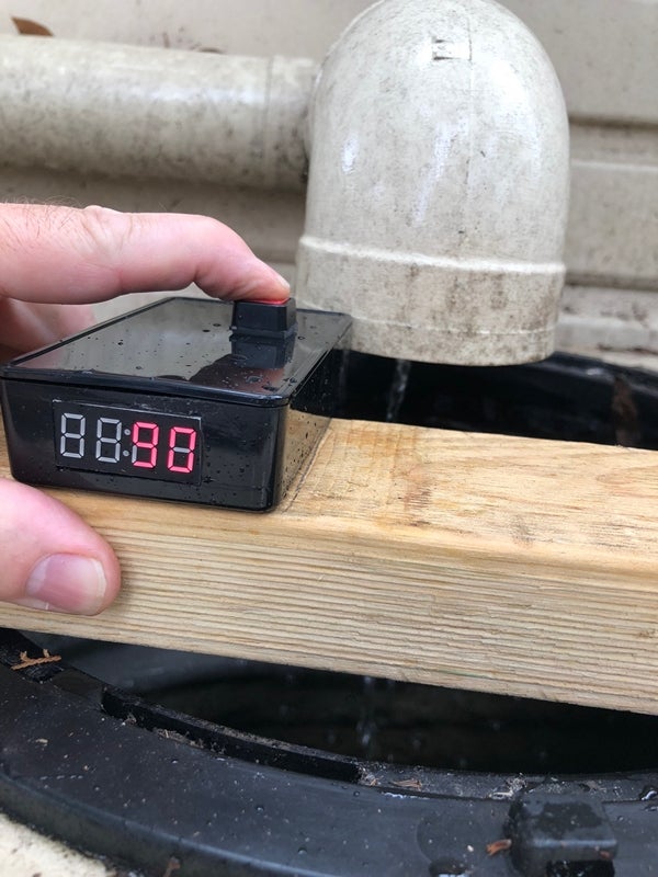

Step 8: The Finished Article
After a few post-assembly tests, and a correction to my code to account for the depth of the chunk of wood I'd screwed the device to (which I completely overlooked in my calculations - d'oh!!), it's all done. Finally!
Assembled testing
With the unit just sitting face down on my bench, obviously there will be no reflected signal, so the unit correctly shows an error condition. The same would be true if the closest reflecting surface is beyond the unit's range.
Looks like from my bench top to the floor is 76cms (well, 72cms plus the 4cm depth of the chunk of wood).
The underside of the unit, showing the transmitter and receiver overhanging the chunk of wood - I should really stop calling it a chunk of wood - it will henceforth be referred to as the Gauge Stabilisation and Precision Placement Platform! Thankfully, this is probably the last time I'll mention it ;-)
Ooh - you can see all those nasty scratches and skate marks in this one...
... and here is the finished item, placed in normal operating mode, actually measuring the capacity of my tank to the nearest 5%. It was a (very) rainy Sunday afternoon that saw me finish this project off, hence the raindrops on the unit, and the very pleasing 90% reading.
