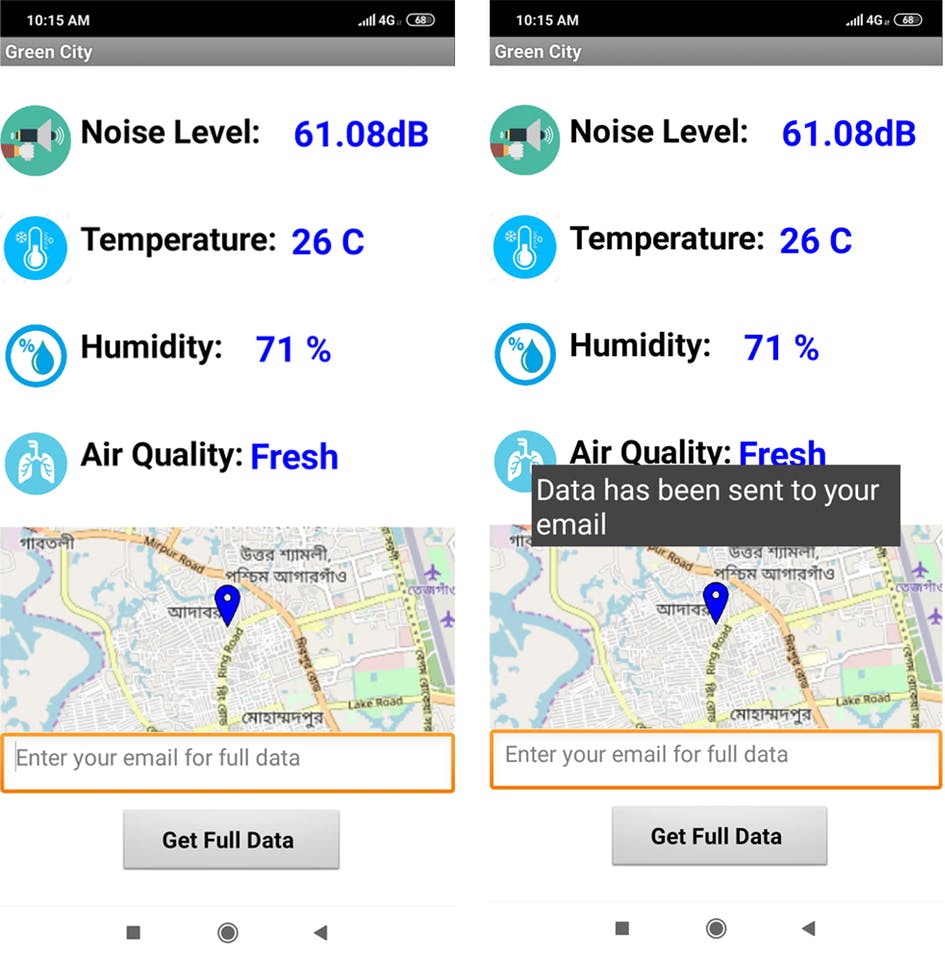

  • Sends data to Ubidots and can be visualized from Ubidots dashboard.

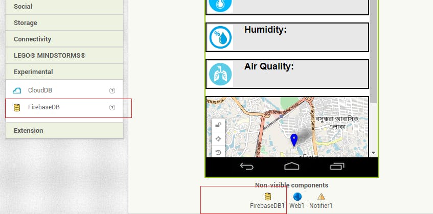

  • Data can be monitored from mobile app and anyone can get an excel sheet of full data through email from the mobile app.

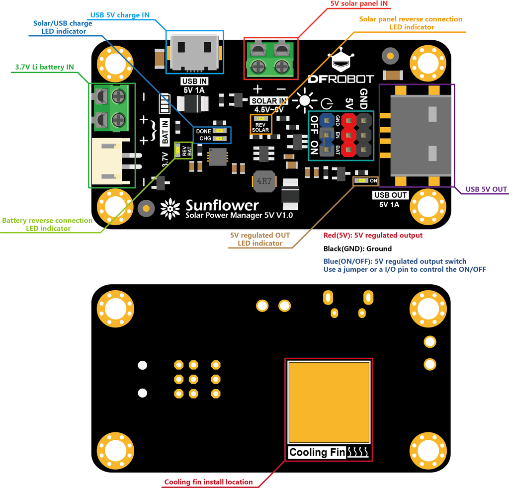

Step 4: Preparing Solar Power Manager
DFRobot Solar Power Manager 5V is a small power and high-efficiency solar power management module designed for 5V solar panel. It features as MPPT (Maximum Power Point Tracking) function, maximizing the efficiency of the solar panel. The module can provide up to 900mA charging current to 3.7V Li battery with USB charger or solar panel. The ON/OFF controllable DC-DC converters with 5V 1A output satisfy the needs of various solar power projects and low-power applications. The module also employs various protection functions for battery, solar panel, and output, which greatly improves the stability and safety of your solar projects.
The module came with a heat sink, 4 hax spacer with 4 screws. I placed the heat sink to the marked placed using the double-sided silicone tape. I also connected hax spacers to every hole using the screw.

One big advantage of using DFRobot solar power manager is that it can provide power to other devices directly through USB cable. So, you can directly connect the Argon board to the power manager circuit through a USB cable. Another advantage is that you can also connect the solar panel to the charger circuit through a USB cable. So no jumper wire or soldering is required.
The solar panel used in the project is a high-performance, lightweight, portable monocrystalline silicon solar panel in a PET package, with an integrated voltage regulator output of 5V, with working indicators, USB type-A mother-port output, plug-and-play. It can supply plenty of power in various environments to prevent the system from shutting down, even in rainy days. The energy of solar panel will be particularly efficient when paired with the DFRobot solar power management board. The panels are provided with open holes and copper clasps so that they can be attached directly to the backpack for easy portability and use. The ultra-thin, lightweight design weighs just 90g. It's much lighter than a solar panel in a traditional glass package.

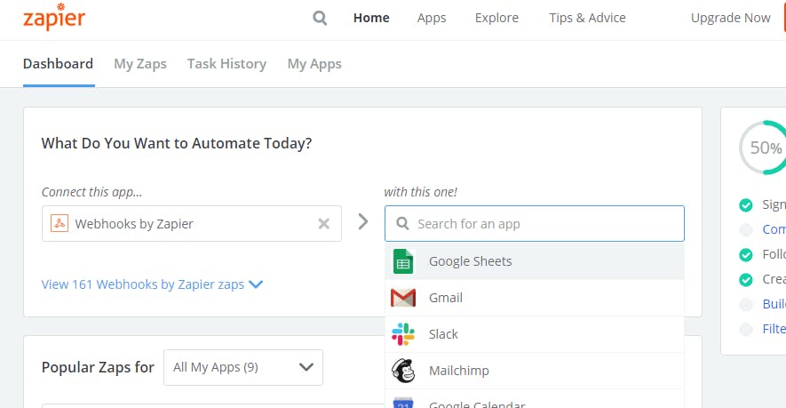

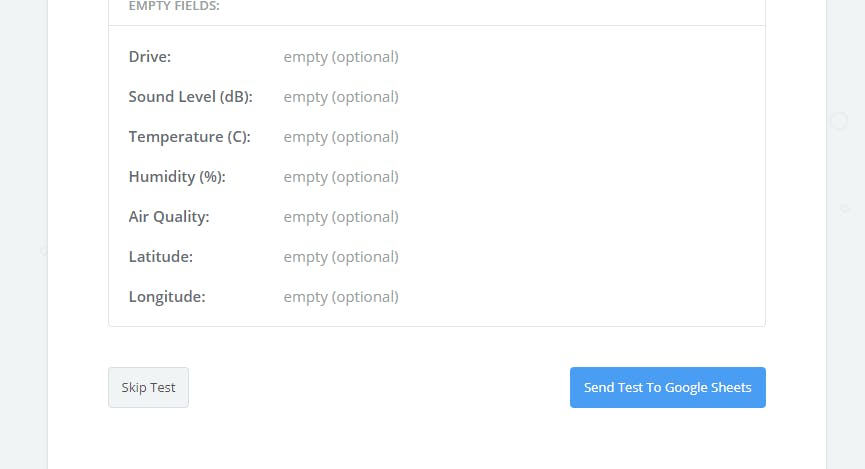

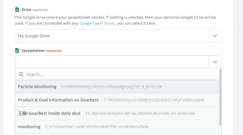

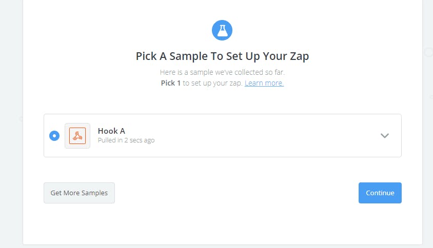

    Particle.publish("Google_Sheet", data1, PRIVATE); //trigger webhook to Zapier for uploading to Google Sheet

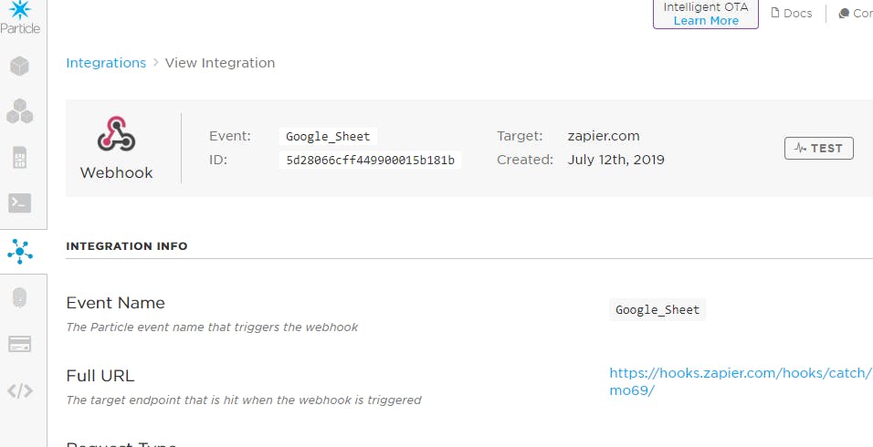

Step 13: Configuring Particle Webhook for Ubidots

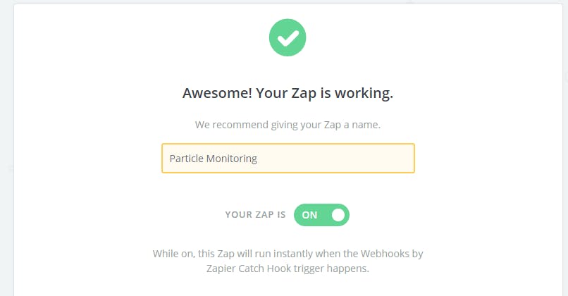

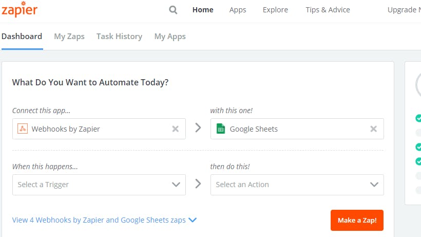

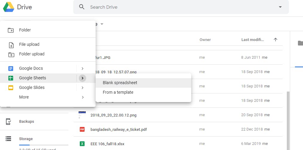

Several web services are used in the project. I used Ubidots for visualizing data, Firebase real-time database for storing the data and accessing the data through smartphone app, Zapier for making a Google Sheet using the data and IFTTT for sending the Google Sheet to user's email. All the web services are connecting to Particle cloud through Webhook.
A webhook (also called a web callback or HTTP push API) is a way for an app to provide other applications with real-time information. A webhook delivers data to other applications as it happens, meaning you get data immediately. Unlike typical APIs where you would need to poll for data very frequently in order to get it real-time. This makes webhooks much more efficient for both provider and consumer. It is very easy to configure webhook for Particle device using Particle console. In next few steps I will show you how I configured webhook for different web services used in this project.
To begin your Particle - Ubidots connection, first you will need to setup your Particle device (Argon, Photon, Core, or Electron) within your particle account. Click here for simple steps to setting up your device with Particle's device platform.
You will also be required a Ubidots account. Ubidots allow free account for education and provides 5000 Credits for free.
Step 1: Create a Ubidots account from https://ubidots.com/education/ and log in to your account.
Step 2: From the right corner click on API Credentials and note the default token.

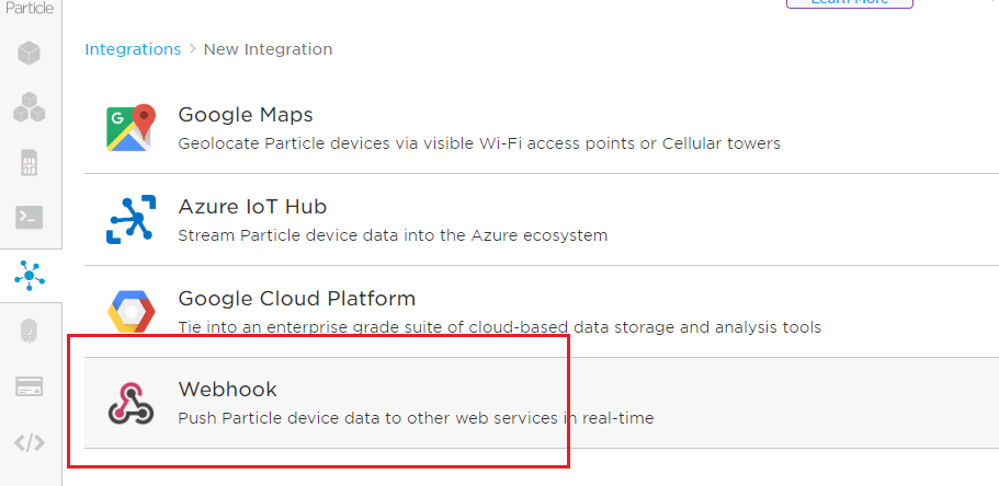

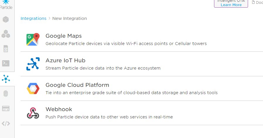

Step 3: Log in to your Particle account
Step 4: Go to your particle console and choose Integrations and click on "New Integration"
Step 5: Select "Webhook"
Step 6: Give an Event Name (1). This name must be same as the event name of Perticle.publish() method for Ubidots. I put the name as "Ubidots".
Step 7: Put your URL at URL text box. Your webhook URL for Ubidots will be as follows: (put your own token without double quote)
<a href="https://things.ubidots.com/api/v1.6/devices/{{PARTICLE_DEVICE_ID}}/?token=" your"="">https://things.ubidots.com/api/v1.6/devices/{{PART...</a> DEFAULT TOKEN FROM UBIDOTS CREDENTIALS"
We're going to automatically call and assign the Device ID of the Particle Device to ensure the device label in Ubidots remains unique. To do this we're going to use the pre-defined key available from Particle:{{{PARTICLE_DEVICE_ID}}} This call will automatically assign to the URL the ID of the device which triggered the webhook.
Other fields should be the same as shown in the figure.
Step 8: Select "ADVANCED SETTING" and complete the text editor with the following text:
Note: For configuring all the web services used in this project follow the link: https://www.hackster.io/taifur/urban-noise-air-pollution-monitoring-d14088

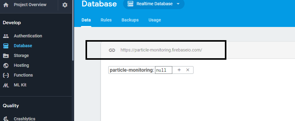

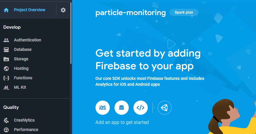

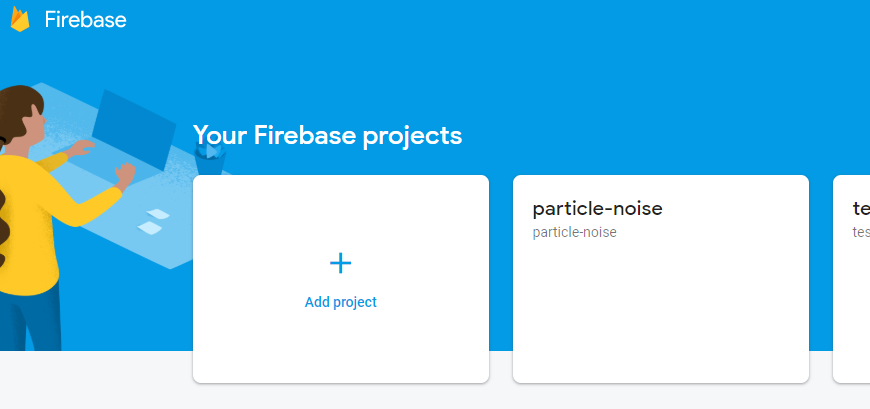

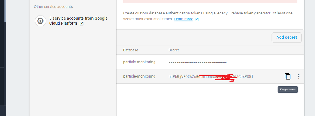

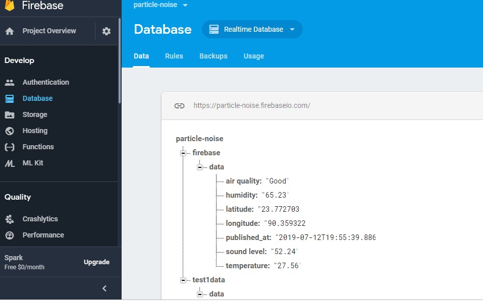

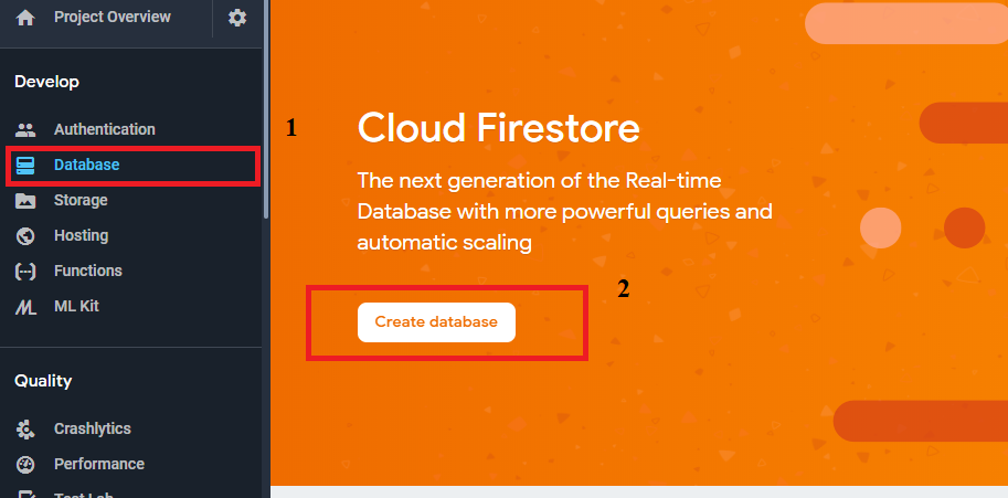

Step 14: Configuring Webhook for Firebase (Real Time Database)
Firebase Realtime Database is a cloud-hosted database that supports multiple platforms Android, iOS and Web. All the data is stored in JSON format and any changes in data, reflects immediately by performing sync across all the platforms & devices. This allows us to build more flexible realtime apps easily with minimal effort.

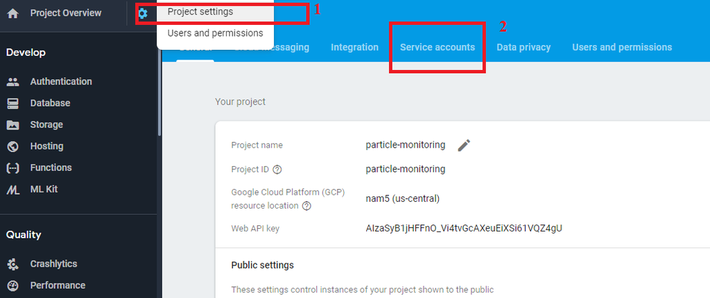

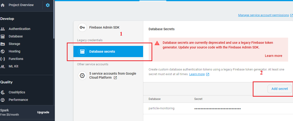

Step 1: Log in to Firebase console console.firebase.google.com/console/login‎using your Gmail account. Click on "Add Project".
Step 2: Give a project name and accept the terms and click to "Create Project".

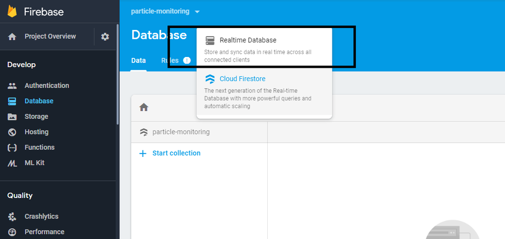

Step 3: After creating project go to Database tab and select Create database.
Step 4: Choose Start in test mode and click to Next.
Step 5: From Database drop down choose Realtime Databse.
Step 6: Note the URL of the database. It will be required later on configuring Webhook from Particle console as well as making Android app.
Step 7: From the Rules tab set read and write permission as true.
Step 8: Go to Service accounts.
Step 9: Select Database secrets.
Step 10: Click on Add secret and copy it.
Step 11: Go to Particle console and from the integration start a new webhook integration. Fill up all the fields as follows. Replace URL with your own URL.
Step 12: Click on Advanced Settings, choose Custom option and paste the following json code:

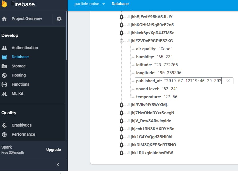

Sensor data will be sent to Firebase as this JSON data. It will look like following.
Finally, click on Create webhook to make it final. Webhook for Firebase is now ready.

Step 1: Go to your Drive and start with a Blank spreadsheet.
Step 2: First row will be the name of the data field (column). Put the name of every column according to your data. In second row just put a sample value for every data. It will help Zapier to identify the data field correctly.
Step 3: Go to https://zapier.com/ and login if you have already created an account. Otherwise create the account first. Start a new Zap. From the connect this app... dropdown choose Webhooks by Zapier and from with this one! dropdown select Google Sheets.
Step 4: Click on Make a Zap!

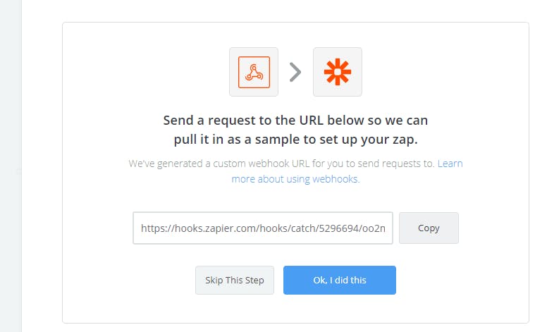

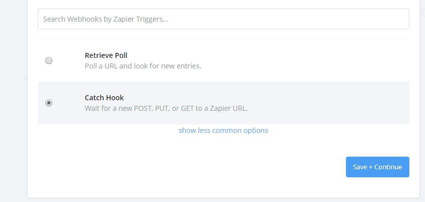

Step 5: Choose Catch Hook and click on Save+Continue.
Step 6: A unique webhook URL will be created for you. Copy the URL to the clipboard. Without closing the tab open a new tab form the browser and open Particle console.
Step 7: Initiate a new webhook creation from the integration tab.
Step 8: Fill up all the field. Paste the Zapier webhook URL to URL text box form the clipboard. For the Request Format select JSON.
Step 9: From the Advanced Setting select Custom option and paste the following JSON code on the text box. This JSON is same as you used for Firebase.
 "temperature": "{{temp}}",
 "humidity": "{{humid}}",
 "air quality": "{{air}}",
 "sound level": "{{noise}}",
 "latitude": "{{lat}}",
 "longitude": "{{lng}}",
 "published_at": "{{PARTICLE_PUBLISHED_AT}}"
Step 10: Click on CREATE WEBHOOK
Step 11: After creating the hook click on TEST to send a test request to Zapier.
If everything goes well you will get the following message.
Step 12: Go to the previous tab from browser and click on Ok, I did this button as you sent a test request from Particle cloud.
Step 13: Select Hook A and click on Continue to go to ACTION tab.

Step 17: From the Spreadsheet dropdown select the sheet you have already created for this purpose.
Step 18: Select Sheet1 for Worksheet field. You will see all the column field you created on the Sheet.
Step 19: Choose the appropriate variable for every column field from Insert a Field option. You will find all the variables from the dropdown you sent earlier as a test request from Particle cloud.

Step 21: Click on send Test To Google Sheets to test either it is working or not.
Step 22: If everything goes well you will get a successful message.
Step 23: Open the Sheet from the Drive and you will see a new row has created. Without time all other fields are empty because we didn't sent any value on test request.
Step 24: Click on Finish
Step 25: Finally turn on the Zap.

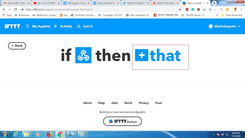

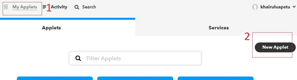

Step 1: Login to IFTTT account and click to My Applets. Click on New Applet.
Step 2: Click on +this.

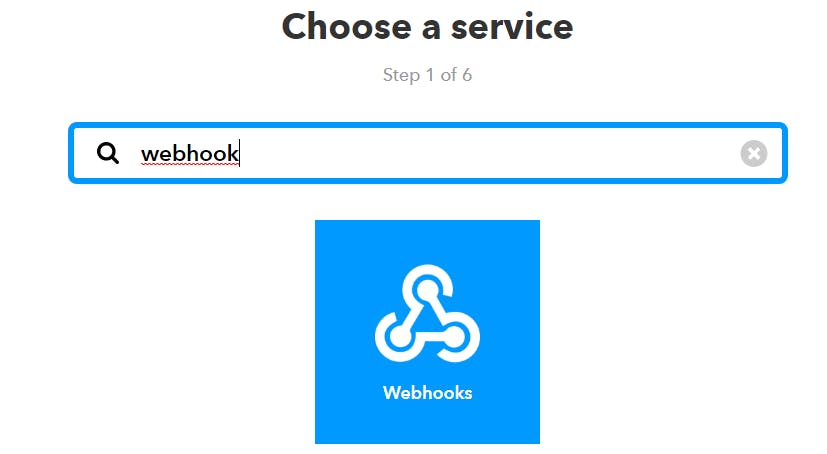

Step 3: Search for webhook and select when it appears.
Step 4: Continue with Receive a web request.
Step 5: Put an Event Name and click on Create trigger. Step
Step 6: Click on +that

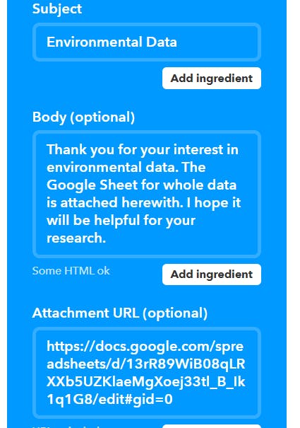

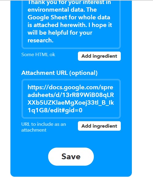

Step 10: Fill Subject and Body with your requirement. Paste the link of the Google Sheet for the text box Attachment URL. This file will be attached with the email.
Step 11: Click to Save to create the Applet.

Making an app using MIT App Inventor is very easy. No coding is required. We will read data from firebase using the app. MIT App Inventor has a built-in extension for interacting with firebase. We just need to add the extension in our project.
For working with firebase you will be required your firebase URL (same URL we use in configuring webhook), the firebase token and the bucket name. Bucket name is actually the table name in firebase.
Block editor explains the interaction between different UI elements. Firebase.DataChanged method triggered for every new data uploaded to firebase. The change reflected in the app in real-time.

You will observe the following output from Firebase console. This is for the PUT method configure in webhook. Without creating any row data is just update.
The following result is observed for the POST request. Every time firebase receives new data it stores in a new row. This may be helpful if you like to export the data.

The view of the android app will be as follows.
If the user sends a full data request he will receive an email and the received email will look like the following:
