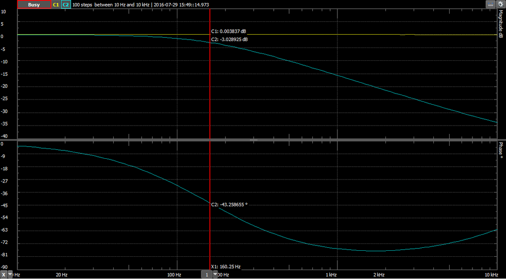

Before we get started, let's look at what we see in the window. You'll see two graphs, the top shows the magnitude of our signal and has a dB scale from 10 to -90 dB on the left. The lower graph shows phase and has a degrees scale from 180° to -180°. (The vertical axis labels are on the far right of the plot windows.) The x-axis along the very bottom of the window lists frequencies on a logarithmic scale, with major divisions at each decade of frequency. (By default 1 kHz, 10 kHz, 100 kHz, and 1 MHz. Logarithmic scales can be a bit tricky to understand at first, but it converts the logarithmic behavior of the circuit to a linear representation, which can be easier to understand visually. You can change between linear and log scales by clicking on the "Scale" box at the top.) At the far right you will see adjustments for the waveform generator, y-axis adjustments for each plot, and the channel adjustments. We will look more at those in a bit.
Build the circuit from the previous step, using a 1μF capacitor and 1 kΩ resistor as shown. Once you have the circuit built, connect the wires as shown below. "1+" connects to "W1". "2+" connects where the resistor and capacitor meet. "1-", "2-", and the cathode (negative lead) of the capacitor all connect to one of the black GND wires.
With everything connected, click on "Run" at the top of the window. The default settings aren't ideal for our circuit, so let's make some adjustments. At the top of the window, you'll see a "Start" and a "Stop" box. Enter 10 Hz for the start and 100 kHz for the stop. The data will take a few seconds to register in the window at low frequencies because the analyzer requires a few readings at each frequency before it prints the data to the window, so be patient and let it run.
We can see everything we need right now with the y-axes set to defaults, but let's make some adjustments anyway. At the right side of the screen, start at the top box labeled "WaveGen". The Network Analyzer takes control of the AD2's waveform generator to do it's thing, and here we have some limited control over it. The default settings here are fine, but you can play with it as you want later. For now, leave it and move down to the "Magnitude" box. Since our circuit is passive, we can't have any gain greater than 1 (0 dB), so the top value of 10 dB is fine, but we can adjust the range a bit. Enter 50 in the range box. Now go to the "Phase" box. The offset box tells you where your center point is on the graph. Enter in -45° here. Now enter 90° in the range box. With this circuit, we won't see a phase shift of more than 90° or less than 0° so those values are now our min/max. You should see the following in your window:

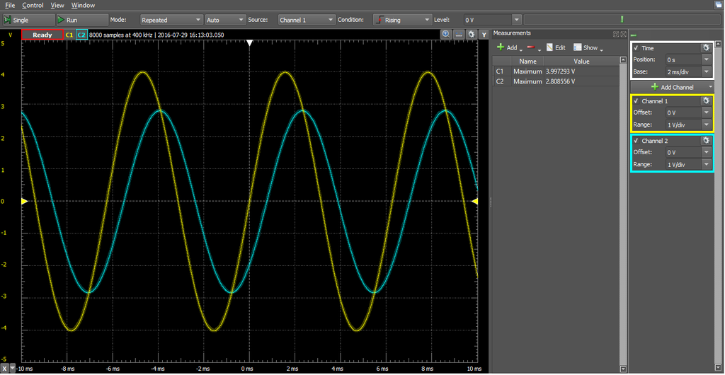

So what is this data telling us? In the magnitude window, you will see that the yellow and blue lines are the same at low frequencies, but as you increase frequency along the x-axis, the magnitude of the blue line starts to drop around 30 Hz and continues dropping from there. We also see that the signals start to go out of phase from each other almost immediately. This data corresponds to the output (blue) data we saw in the oscilloscope window at low and high frequencies.
But what else do we see here? By convention, filters are designed to start filtering signals at a specific frequency, defined in radians per second. It is a filter after all, so it has to start filtering somewhere. For the resistor/capacitor filter, this is found by finding the inverse of multiplying the capacitor and resistor values together, or 1/(R*C). To find the frequency in Hz, we then divide this value by 2π. This gives us a cutoff frequency for our circuit of ~160 Hz (1/(0.000001 F * 1000 Ω * 2π) = 159.15 Hz) . This cutoff frequency is where the magnitude of our output is 70.7% of it's maximum value. Another way to find this value is to divide your max value by √2, or 0.707107. (1/√2 has many important applications in engineering in general, but that is beyond the scope of this I'ble.) Go back to the oscilloscope and put a 160 Hz signal at 4V peak voltage into your circuit. You should expect the blue output trace to have a value no higher than 4/√2, or ~2.83V. Let's look at that.
We see that the real numbers are 3.997V for channel 1 (yellow input) and 2.809V for channel 2 (blue output). 2.809V/3.997V = 0.703, which is close enough to 1/√2 for me. I've done some rounding and assumed nominal values on the components were the actual values, all of which can account for the slight variance from ideal.
The cutoff frequency is generally accepted as the point at which your input frequency will be attenuated to a point that it is considered unusable. It's usually an arbitrary value since you want to set it well beyond the max frequency you expect your circuit to ever see.
If you click on the small X at the very bottom left corner of the network analyzer window, a small cursor will appear at the bottom of the window along with a vertical red line on the graph. Click on the small X at the bottom of the vertical red line to drag the cursor to 160 Hz. Little labels will appear on the plots showing the magnitude and phase values at that frequency. Notice on the magnitude graph of the network analyzer, at 160 Hz the magnitude of the output has dropped to a point known as the -3 dB point, which is just 3 dB below maximum. Since our max value for any passive circuit is 0 dB, we end up at -3 dB with this circuit. This point on the dB scale corresponds exactly to dividing the magnitude by √2 on the linear scale from the scope. It is also where we achieve an ideal phase shift of -45°. We can see in the plot that for the parts I used, I have a phase shift of -43.3°, which is good enough. As I mentioned before, this point is very important in engineering and has many applications that are beyond the scope of this I'ble.
At frequencies greater than our cutoff frequency, we can see that the magnitude plot begins to have a nearly linear downward slope. (It appears linear because we are using a logarithmic scale.) The slope of this line, with a first-order circuit, will be -20 dB/decade of frequency. That means that as we increase the frequency by an order of magnitude (1 kHz to 10 kHz, 10 kHz to 100 kHz, etc.) we should expect to see a drop in output signal strength of -20 dB each time we do that. By inspection I see that at 1kHz, the output magnitude has dropped to just below -15 dB. At 10 kHz, it is at just above -35 dB. It's not exactly -20 dB, but for the purpose of illustration, it looks like -20 dB to me.
By inspection. we can also see from the image above that we were also right on with our phase shift calculation of 75.6°. At 1 kHz, we see that our phase angle is right between -72° and -81°, which for this example is close enough for me.
