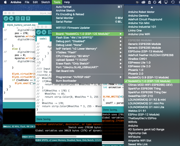

Before you can use the code, you'll need to download the libraries that the code uses (the ones at the top of the code). Read through and follow this guide from Adafruit (start at "Using Arduino IDE") for what you need to do to set up for the ESP8266. Yes: you'll need to install the CP2104 Driver, add to the Additional Board Manager URLs in Arduino preferences, install the ESP8266 package (go to Sketch > Include Library > Manage Libaries... and search up what you need -- see picture below), and also install the other libraries at the top of the code for neopixel, Blynk, etc.
To upload code to the ESP8266 chip from the Arduino IDE, you'll need to select the correct board (NodeMCU ESP8266 ESP-12E), flash size, port, etc (see picture below). The correct port SLAB_USBtoUART won't show up unless you plug the ESP8266 to your computer. But once it's connected, and you're sure you've correctly connected your circuit in the previous step, you can go ahead and press the arrow in the upper left corner to upload your code to the board. Yes, it does take longer than your usual uploading-to-Arduino process. You'll see it compile the code slowly, then a string of orange periods .................. as it uploads (displayed in the Arduino window's bottom black part).
