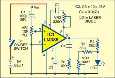

This simple Laser Communication System consists of two sections Transmitter and Receiver. At the Transmitter any audio device can be coupled to the laser light by using a transistor operating in common collector mode. Since, In common collector mode transistor acts as Impedence matching device. Due to this intensity of the laser beam changes proportional to audio signal strength.

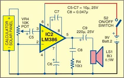

At the receiver this varying intensity can be sensed by any optical sensors like Light Dependent Resistor (LDR) or photo transistor or Solar cell. The photo transistor is biased and connected to the input of audio amplifier (LM386) which drives the loud speaker.

Step 1: Transmitter
easy.. here we are transmitting an audio signal
Step 2: Receiver
solar panel can be replaced by LDR or photo transistor
