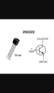

transistor 2n2222

now at first take your 2n2222 transistor and inser it in your pcb, then solder a 56 ohm resistor and a 1 k ohm resistor in series with the collector of the transisitor now one end of the transistor was soldered to the collector now solder the left out wire to the base of the transisitor
then solder one leg of the ldr to the point where the resisitor and base of the transisitor is soldered and then soder the left out leg of the ldr to the negative terminal of the battery cap, and solder the possitive terminal to the point where the resistor series and collector of the transisitor are soldered,now solder the possitive terminal of the buzzer to the emitter of the transistor and the negative one to the point where the negative terminal of the battery cap and ldr are soldered.
