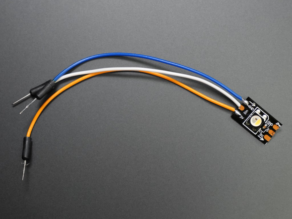

Step 2: Add NeoPixels
Let's upgrade this circuit's output with some color changing addressable LEDs, aka NeoPixels. You just need one at the minimum, and the sample code later in this lesson uses six. I don't recommend using more than ten pixels for this exercise. If you haven't already, you can learn to solder wires onto your NeoPixels and install the Arduino code library by reading the Skills Infusion lesson in my free Arduino Class. You might find it helpful to resize your browser window so that this lesson is visible along side your Arduino software window.
Wire up your NeoPixel(s) to your existing circuit according to the following diagram:

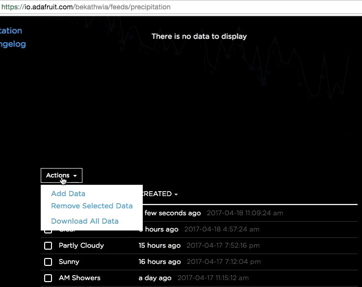

Step 3: Collect Weather Conditions in Feed
Up until now, our feed's data has consisted only of 0s and 1s. Let's see what happens when we collect some weather data into a new feed called "precipitation". To get an update each time the current weather condition changes, create four IFTTT applets that send data to the same precipitation feed using the Weather Underground trigger, each with a different one of the four condition options. Since this feed is only updated when the weather changes, it can take a few days to see the variation in the data.
Instead of numbers, the feed is filled with words representing a variety of weather conditions. In Arduino, this feed data type is called a String, which is an object that can store multi-character text. You can learn more about this variable type on the official Arduino site, and explore several String examples in the Arduino software. Since we are looking to evaluate the strings in the feed, the StringComparisonOperators example is particularly relevant. In the sample sketch (also accessible in your Arduino software by navigating to File-> Examples->08.Strings->StringComparisonOperators), you can find several if statements with descriptive comments that explain and show how to compare two strings in several different ways.

To test this code, you can manually add data to your feed by clicking on Actions -> Add Data. Type in a weather condition (stick to the ones described in the Arduino sketch) and click Create to add it to the feed. If all's well, your pixels should change whenever the feed updates.
