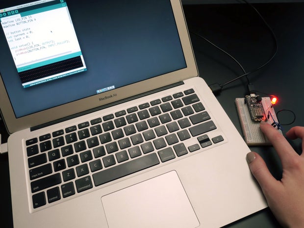

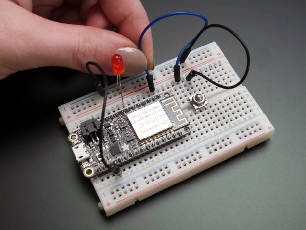

Wire up and test the pushbutton circuit from the Hardware Setup lesson.
After uploading the pushbutton code to your board, you should have a circuit that lights up an LED when the button is pressed. Next we'll add in some code to send a message to Adafruit IO each time the button is pressed, and create a corresponding feed to catch that incoming data.

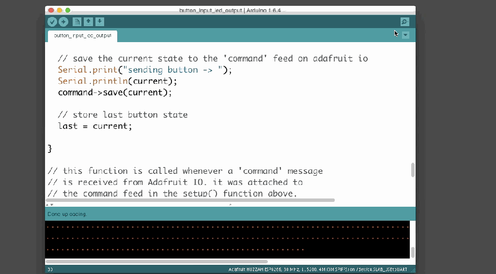

Step 4: Troubleshooting With the Serial Monitor
The serial monitor is an indispensable tool in your Arduino toolbox. The sample sketch is composed with helpful status updates that print to the serial monitor while the board is connected to the computer. In the Arduino software, you can open it up by clicking the magnifying glass button in the upper right of your sketch window, and set the baud rate to 115200 (matches the serial port created in the code’s setup function). Press the reset button on your board to start its sketch from the beginning, and see what info pops up in the monitor.
Does everything appear to be in order with no errors in the Arduino software? Cool, that means you've probably got data in Adafruit IO to check out! Navigate to your "command" feed in the browser and check to see what your data input looks like so far. (Once logged in to io.adafruit.com, click on "Feeds" on the left side of the page, then click on the name of your feed, "command".)

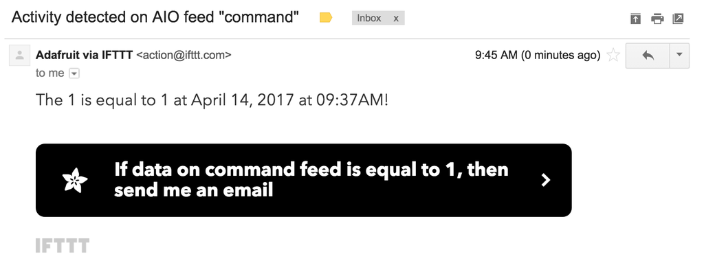

Step 5: Connect IO Feed to IFTTT

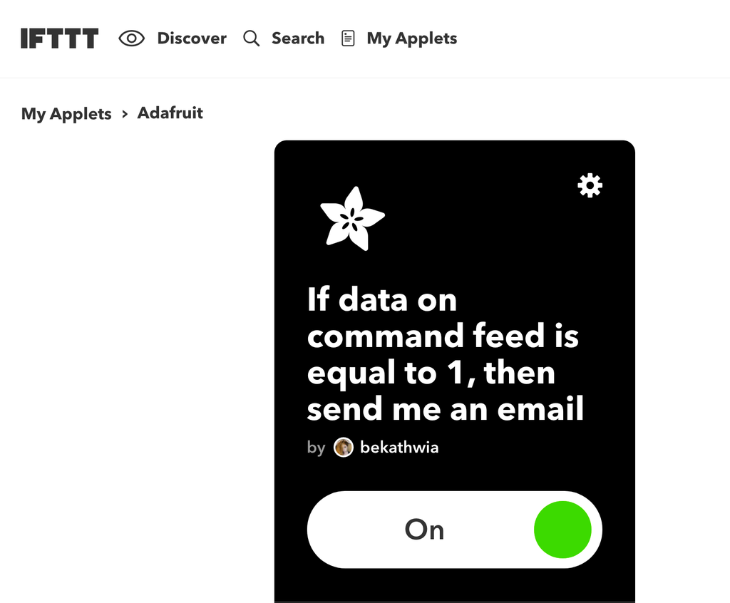

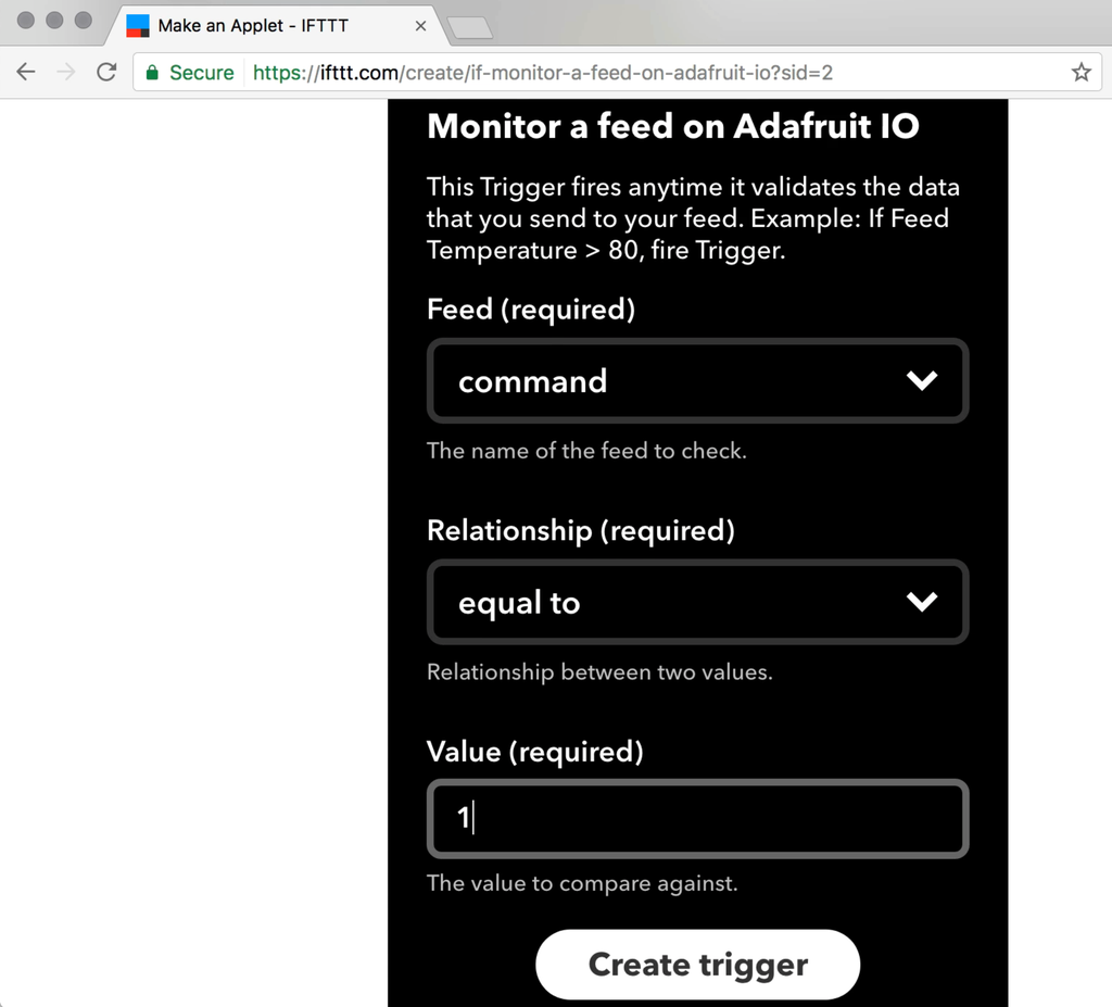

Sign in to your IFTTT account and click My Applets at the top of the page, then the button marked "New Applet" on the right of page. Click "+this" to choose an input service, and start typing "Adafruit" into the search bar until it appears, then click the button marked Adafruit to see the available triggers. For this example, either trigger will work, but for the sake of showing more settings, choose "Monitor a feed on Adafruit IO."
From the dropdown menus, select the feed name "command" and the relationship "equal to". Type the number 1 into the Value field, then click the button marked "Create trigger".

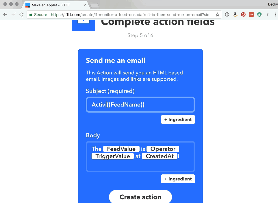

Next, click "+that" to choose an output service, and then click "email" (or choose a different output service like Twitter, SMS, etc.). Click through to customize the email message, then click the button marked "Create action". Lastly, customize the name of the applet (if you wish) and click the button marked "Finish".
Now when you press the button, you should see an email in your inbox (up to a few minutes later).

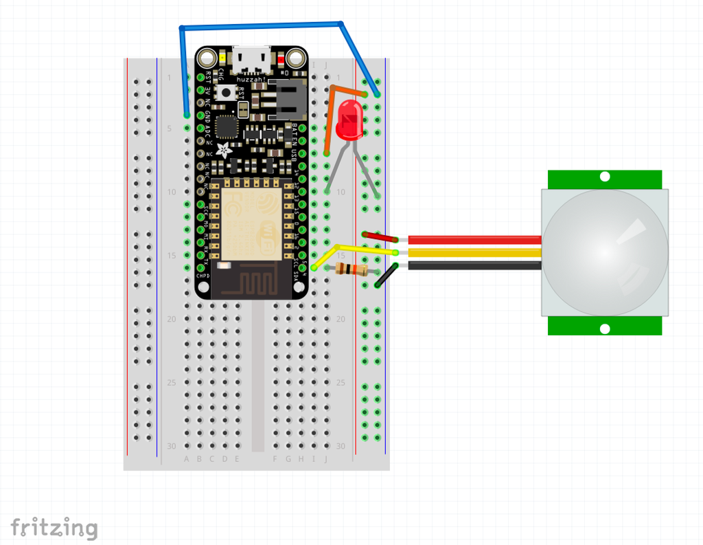

One particularly fun upgrade to this circuit is to add a PIR motion sensor. PIR stands for Passive Infrared, which describes how the sensor works— by detecting changes in the overall amount of IR light it can "see" with its collector dome. This sensor is designed to output a simple HIGH/LOW signal when its (adjustable) threshold is exceeded, so we can easily use it in place of a pushbutton using the same circuit we've been using all along. In addition to the PIR motion sensor, grab a one more wire (for powering the sensor), a 10K ohm resistor (brown, black, orange, gold) and wire them up according to the following circuit diagram:
The PIR motion sensor comes with a wired three-pin connector that plugs into three header pins on the sensor board— the black wire should line up with the pin marked GND.

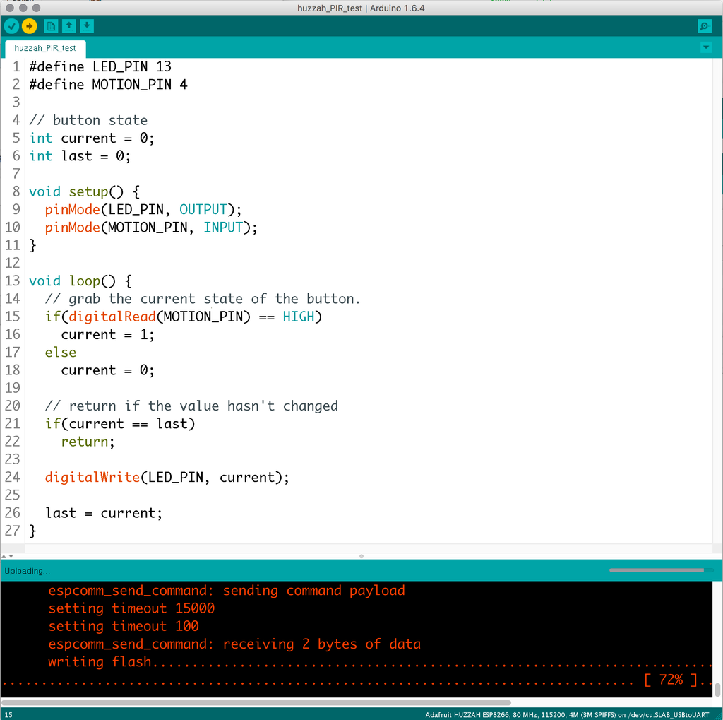

The code to test the motion sensor is very similar to the button test code, with some minor (but significant) changes. Since the motion sensor sends a HIGH signal when it detects movement, we'll need to remove the internal pull-up resistor from the pinMode declaration in the code's setup, and change the main if statement to check for a HIGH signal instead of a LOW.
#define LED_PIN 13

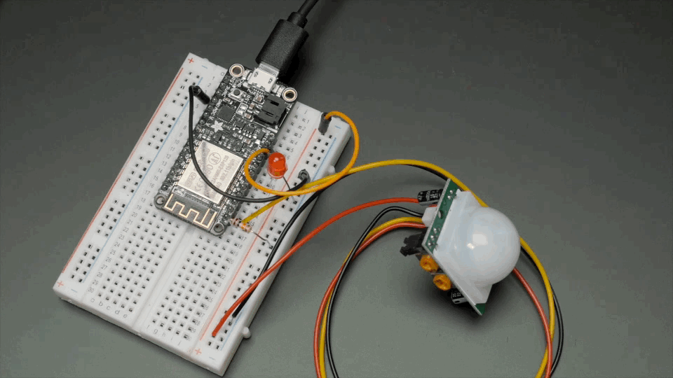

Copy or download this code into your Arduino software (a new blank sketch, please), or if you're feeling adventurous, make the two small changes we just mentioned to your button test code by hand and save the file with a new name, such as huzzah_PIR_test.ino.
Upload the PIR test code to your Feather Huzzah and test that waving your hand in front of the sensor causes the LED to light up for a few seconds, then turn off again. You can adjust the sensitivity of the trigger and the duration of the HIGH signal by turning the sensor board's tiny potentiometers with a small screwdriver.
