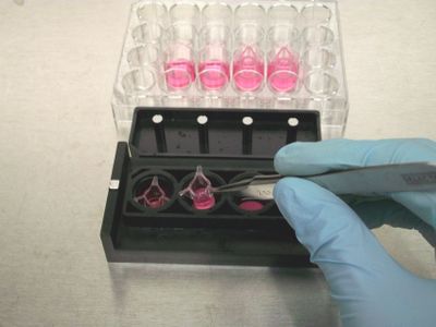

iPorator requires special electrodes during transfection (Primax Bioscience, E24A1108). Fill bottom electrode chamber with 1mL of Opti-MEM. Transfer the inserts with GFP into bottom electrode chamber and put in the top electrode.
Next step, put the electrode set with inserts into the iPorator.
Click “Transfection” in the user interface.
The program has a build-in MDCK-G DNA transfection protocol, so I just select that protocol and click “Start”. It takes about 4 minutes to finish the transfection.
