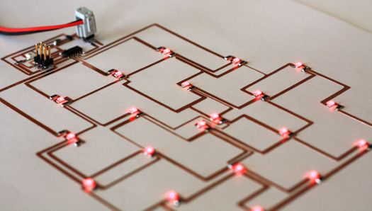

This is a circuit made with the vinylcutter. The project involved designing the circuit, cutting it out of copper sticker, glueing it on paper, stuffing the electronic components and programming the micro controller to make the LEDs light up in a pattern. Step by step instructions how to do this will follow soon, here are some pictures of the process.
Step 1: Designing the Circuit
The design was based on the Charlieplexing array output board from the Fab Academy. These files provided a good basis to start from. I designed the circuit that contains an ATtiny 44 micro controller in Eagle.

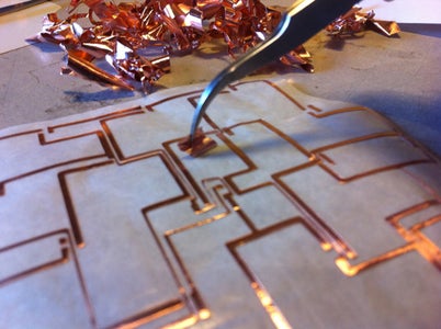

Step 3: Weeding the Copper
Place a piece of transfer paper on the copper as soon as the machine is done, and while the copper is still glued to the cardboard. If you wait too long all the traces will start to curl up. Then take the copper sheet off the cardboard, and pull off the backside of the sticker. Now you can start weeding the copper that is not needed in the circuit, leaving only the traces behind on the transfer paper.
