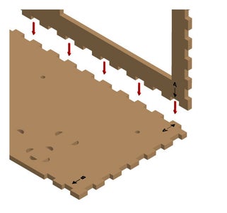

Step 2: Assemble the Case
Add a little glue to the edges of each plate (A-1 through A-5) and press fit them together. The arrows and letters on plates A-1 through A-4 should match up as shown in Image 1.
You might want to use some clamps if the plates don’t stay together on their own.
Be sure to wipe away any excess glue that squeezes out when you press the plates together.

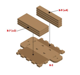

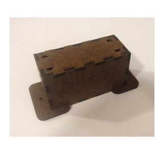

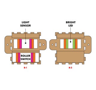

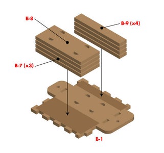

Step 3: Assemble the Card Reader
Glue the spacer plates (B-7, B-8, B-9) to the two the front and back plates of the card reader (B-1 and B-2) as shown in Image 2 and Image 3.

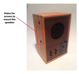

Next glue the sides (B-3), top (B-4), and bottom (B-5) to the back plate (B-2) as shown in Image 4.
Glue the other top (B-4) to the front plate (B-1).

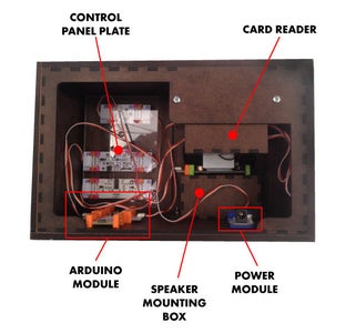

Step 4: Insert Modules
Insert the LED, Light Sensor, Roller Switch, and Wire Modules as shown in Image 5.
Tape the LED spacer (B-10) to the LED Module and the Light Sensor Spacer (B-11) to the Light Sensor as shown in Image 6.
Add the front plate (B-1) to the back plate assembly (B-2) but do not glue them together.

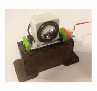

Step 5: Assemble the Speaker Mount
Add a little glue to the edges of each plate (C-1 through C-4) and press fit them together.
You might want to use some clamps if the plates don’t stay together on their own. Be sure to wipe away any excess glue that squeezes out when you press the plates together.

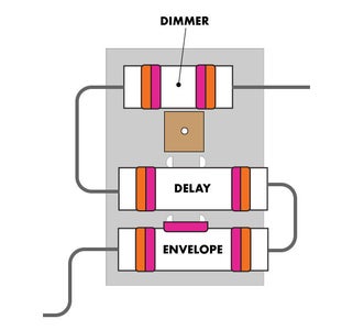

Step 6: Assemble the Control Panel Plate
First create the spacer by inserting the ⅛” nut into the hole on E-3.
Glue one E-2 on top of it and two E-2s below it as shown in Image 7. Be sure to wipe away any excess glue that squeezes out when you press the plates together.
When this assembly has dried, use a machine screw to attach the spacer you just made to the control panel plate and add the Dimmer, Envelope, and Delay Modules as shown in Image 8.
Next add a dab of glue to the top of the spacer and insert the entire assembly into the case you assembled in step 1.
The nobs from each module should poke out of the holes on the front plate of the case. Clamp the control panel plate to the front plate, making sure the spacer is making contact with the front plate. If you need to remove the control modules later, just unscrew the plate from the spacer.

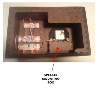

Step 7: Add the Speaker Mount to the Case
Place the speaker mounting box you made in step 3 inside the case. Insert two machine screws through the small holes in the bottom of the case and up through the holes in the base of the speaker mount. Add nuts to the screws to keep the mount in place.

Step 9: Mount the Card Reader
Insert the card reader into the slot cut out on the top of the case.
Run the 2.5” machine screws through the holes in the rear of the case and through the tabs on either side of the card reader.
Add a bolt to the end of each screw and tighten to hold the card reader in place.

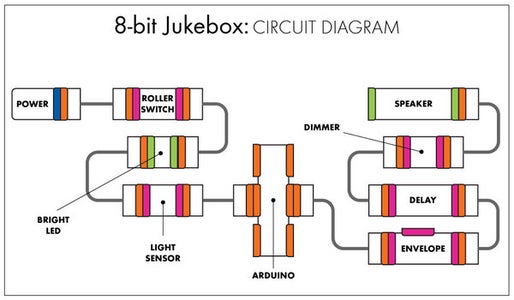

Step 10: Add the Remaining Modules
Place the feet of the Arduino Module in the holes on the bottom of the case (see Image 9). Do the same with the Power Module and use the remaining Wire Modules to complete your circuit.

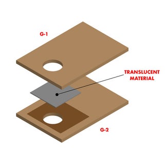

Step 11: Create Your Song Cards
Assemble the four song cards.
We experimented with a lot of translucent materials in our shop. Several layers of regular printer paper worked quite well. The silver anti-static bags that our modules ship in also worked. Whatever materials you use, you will want to be sure that each card has a different level of translucency.

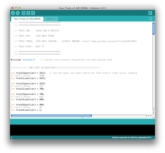

To measure how much light each card is letting through, upload the Card Calibration code from the link above onto your Arduino and keep the Arduino plugged into your computer.
Once the code is uploaded, open the serial monitor in the Arduino IDE and insert each card into the slot.
Once every second the serial monitor will show you a value between 0 and 1023. This number represents how much light is reaching the Light Sensor Module. Record this number for each of the four cards. In a moment you will use these numbers to adjust the code for the music box.
NOTE: Try to have the values for each card as far apart as possible (e.g. 100 , 400, 700, 1000). You might need to play around with adding and subtracting layers of your translucent materials until you get numbers that work well. If the numbers are too close together, your music box will have a hard time telling the difference between the cards.
Step 12: Program Your Arduino Module
Once you have your cards made, download and open the 8-bit Music Box code that is included with these instructions. Go to the part of the code where you can calibrate your song cards. Each card has an upper limit and a lower limit. If the light sensor reading falls between these two limits, that song will play. If necessary, edit the values for these light limits so they work with the cards you have made. Be careful not to overlap these values. If you do, your songs will not play correctly.
