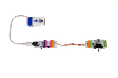

Step 1: Create the Circuit
Build the littleBits circuit:
power +remote trigger + wire + DC motor
