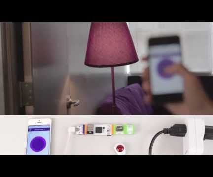

When away, make sure your pet (fish, cat, dog) never goes hungry with this WiFi-activated feeder. With this littleBits project, you can either feed your pet remotely by pressing a button on your phone or automating a feeding schedule through IFTTT (If This Then That). IFTTT is a service that lets you connect to different web apps through simple conditional statements.
Make this project with littleBits. littleBits is the easiest and most extensive way to learn and prototype with electronics. We are making hardware limitless with our award-winning, ever-growing library of electronic modules, ranging from the very simple (power, sensors, LED) to the very complex (wireless, programmable). This project uses the littleBits cloudBitTM. The cloudBit lets you connect any device to the internet, turning any object into an internet connected device in a snap – no soldering, wiring or programming required. Instructions for setting up the cloudBit can be found here.
How it works:
Any time the feeder receives a signal through the cloudBit, the servo is activated. In our case, we attached a fish food container with a small hole drilled in its side to the servo. When the servo turns, a few pellets drop out of the container and into the bowl.
You can activate the servo remotely in a couple different ways. You can either use the littleBits button in Cloud Control to send a single pulse to the cloudBit, activating the servo. Or, you could use an IFTTT channel, like Date & Time to automate the feeding at times you set.
