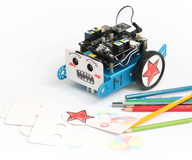

Introduction: MBot Controlled by Wireless Joystick Using Me USB Host
Me USB Host is an adapter for USB devices. You can use it to connect a Arduino board to a USB device, such as a USB joystick, a mouse, or a thumb drive. So you can control your robot with your own joystick or something else. Now, we can add new controller method for mBot using wireless joystick.

mCore can communicate to me usb host with software serial, because there is not RJ25 Port for hardware serial in mCore.
the processing : DC Motor <-- mCore <--> USB Host <--> USB 2.4G Dongle <--> Wireless Joystick
