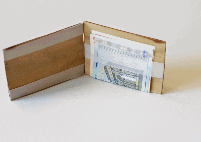

Looking the animation you see how the wallet can be opened from both sides. The real trick is not showed here, and consists into the next procedure:
- place the pack of banknotes (not too much please, send me the surplus!) on the inside of the wallet, over the ribbon, or the ribbons, of one face
- close the wallet, paying attention that all the banknotes are inside the borders
- open again the wallet, but this time from the opposite side
- all the banknotes are now magically held by the ribbons as in the pictures
If you're good enough to not let your audience understanding that the wallet can be opened from two sides, they hardly believe that you're so fast to insert the money underneath the ribbons!
