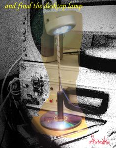

fist of all go and connect the connector and the usb to test the lam....all ok? Bright.....so now we have a difficult part but for was enough easy.
we need 4 old uselless CDs, Copper Wire 30cm (12inc) of diam 3mm, silicon gun, hacksaw, glue.
About the copper wire i told some details earlier but if its difficult for you to get some email me to give you some ideas. This copper wire costs about 6euro the 2m
After the cutting we have a nice 30cm piece of copper wire. Now we have to bending it. Copper is very flexible so try with small movements to bend the wire in the desired posistion..My desired angle is about 40-45 degrees. The bended part must be the 1/6 of the 30cm wire.
The problem now is how th wire can hold the lamp. I found the simplest solution. With the soldering gun i open a channel in the middle cover of the lamb ( the place of the batteries) big enough to fit the copper wire. I put the copper wire in the channel and then with a soldering gun i put plenty of hot silicone to hold tight the copper wire....thge job done perfect. I cover the lamb with the bottom cover with the screws and and the job was done clear and smoothly.
Now we take 4 glued cd's and we use the hot silicon to attach the other end of the copper wire to the cd's hole. If u have a small 7cm tube (plastic or mettalic with diameter less than 1cm will help to ensure the attachement of the copper wire.
The whole jobe is done. For any extra info please contact with me
