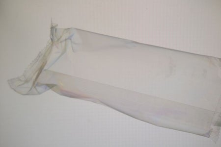

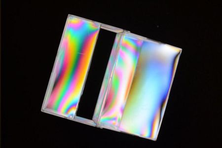

As an example, you can see a cookie packaging plastic without and with polarizing filter.
Adjust focus and exposure time on your camera. I can not give you hints here, it is a matter of trial and error.

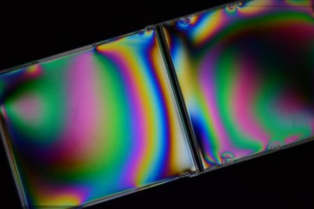

Many apparent uniform materials generate colored pictures indicating that the physical properties of the objects are not uniform. Stress points can easily be demonstrated using this setup.
But aside of all the science, the pictures are nice to look at...
