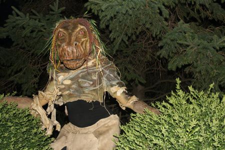

Step 6: Applying It to the Model
finally once it is all done we have the pleasure of putting it all together and seeing it move ....
the only snag we really hit was creating an transition between the hands and the upper arms but we made a really kool makeup in between and the paint saved the day.
all the shots we have are in front of a green screen because are final presentation of this creature was meant for a digital final copy but it worked just as well out and about .. throw a clock around it and u have a creature that Jim Henson would probably be proud of.
enjoy the pics and hope you enjoyed the process
once again thank you everyone who was involved with this it was awesome fun!
