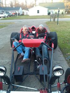

it all started when I noticed my buggy engine would run a little hot on the highway so I came up with an idea to make a scoop to help force cool air into the cooling shroud.
the only reason could come up with as to why it only happened when I was driving was because it was being blocked, kind of like flying your hand out the window it catches air and wants to lift but if you put it behind a car door mirror it falls in the stale air

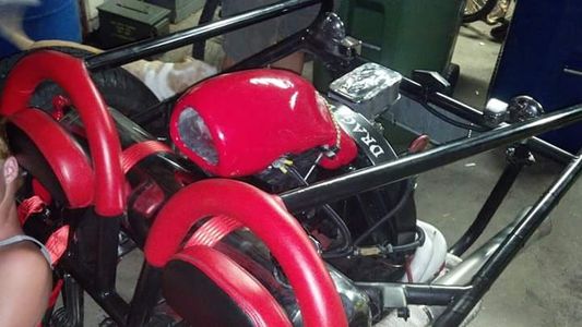

Step 4: Installed
once installed I did a series of temperature test at idle and while driving. the air scoop did the trick it went from 240°F - 250°F. down to 200°F -210°F on a hot summer day. I also installed an oil cooler and fan later on and it brought it down to 180°F 190°F.

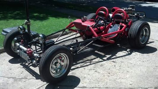

I'd like to add that the engine has all of its cooling tins and has no leaves or mud or debris blocking the fins... its a 1776 turbocharged engine with flat top mahle pistons and cylinders 7.4:1 compression and 7 lbs boost. as well as turbo cam with straight cut gears, 8 dowel crank and h beam con-rods. it makes around 190 HP and the 0 to 60 time is 4.1 seconds. the whole thing weighs 1,114 lbs. it might be faster but I'm afraid of destroying a 3rd transmission. so I feather the petal so it doesn't give a sudden jolt from a dead stop basically I don't dump the clutch and I limit the engine revs at or under 5,000 rpm
