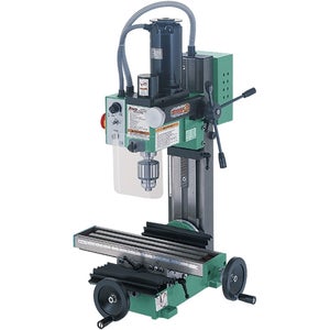

The mill is an X2 "mini mill", manufactured by Sieg and imported and sold in the US by Harbor Freight, Grizzly, etc.

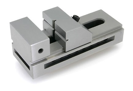

The milling vise is a small screwless toolmaker's vise with clamping slots, sold by Little Machine Shop, Shars.com, etc.

The bottom surface of the vise's clamping slot is about 0.595 inch above the table, and the top surface of the clamping slot is about 0.300 inch above the bottom surface.

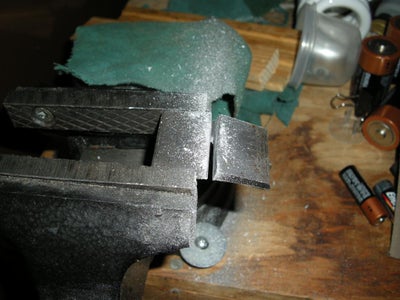

Step 2: Rough Cut the Angle Iron
I put an abrasive cut-off wheel on my wood-cutting compound miter saw and cut the angle iron on that. It cut fine, but it got hot enough to melt the plastic part of the saw's table.... That made me feel kind of stupid, I hope no one notices.
Anyway, I cut about a 1 inch wide piece off the length of angle iron. The exact size is not very important.

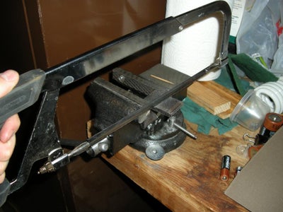

Then I cut off part of one "leg" of the piece, this will be the foot of the clamp later (where it stands on the mill's table). I learned my lesson about the plastic-tabled saw and made this cut with a hacksaw.

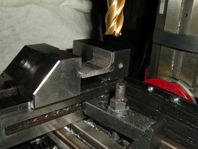

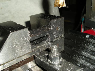

Step 3: Clean Up the Long Edges
I set up the angle iron in the milling vise and milled the long cut edges nice & flat (& somewhat to size, though this dimension is not terribly important).
The pictures show the setup for milling the two long sides. The rounded end of the angle-iron fits into the horizontal V-groove in the movable jaw of the vise. The edge that I'm milling is sticking out 1/4 inch or so past the vise jaws. This setup was plenty secure.
I eyeballed the workpiece to find the part that was sticking out the most, and gently touched off the cutter at that point. Then I started doing cutting passes in the Y direction, front to back, so each pass was done in conventional milling mode (I'm staying away from climb milling for now). Each pass took off about 0.010 inches of material, on whatever parts of the workpiece were sticking out. Eventually it cut along the whole face of the workpiece, and then I did a 0.005 inch finishing cut and called it done.
I used a 3/4 inch 4-flute milling cutter spinning at something like 800 rpm. Feedrate was probably about 5 or 7 ipm. Depth of cut (of each cut) was about 0.010 inch. I occasionally squirted WD-40 on the cutter and workpiece while cutting.
To mill the other long side I flipped the workpiece upside down (as shown in the second picture). The location of the V-groove in the vise jaw and the length of the foot (the short leg of the angle iron) conspire to make this possible. If the dimensions hadn't worked out I could have kept the workpiece in the "foot-up" orientation and slid the workpiece to the other side of the jaws.

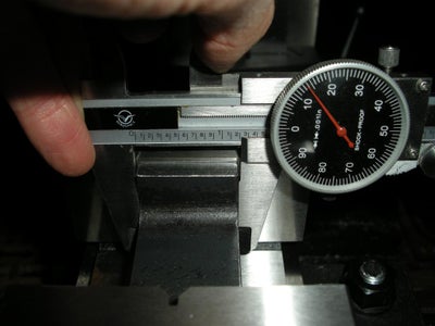

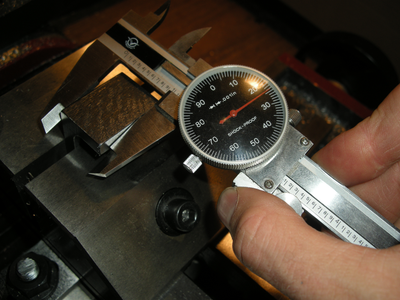

Once it was flat along the whole bottom of the foot I measured the foot height with calipers (I wiped the reference surfaces with a rag so the swarf wouldnt throw off the reading). This measurement told me how much material I had to remove. I took it off in 0.010 inch cuts until I got within about 0.020, then I measured again and took shallow cuts until I got within 0.005 inch, then I called it good.

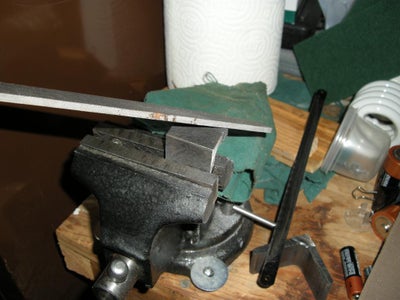

Step 5: All the Facing Is Done
Here it is with all three faces in order and all the edges of those faces filed smooth.
Now it's all over but the slotting.

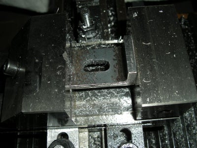

Step 6: Slotting Setup
For the slotting, I set it up like this.
It's nice to have the workpiece roughly centered in the jaws, because it gives even clamping pressure, not so much twisting force on the movable jaw.
I want the slot in the middle of the clamp, so I measured the final, actual width of the clamp, located the edge, and positioned the spindle at the X axis center of the clamp.
Lock the X gibs here, we'll just be moving in Y and Z for a while.

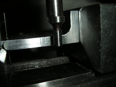

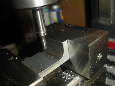

Step 7: Locate the Foot
Touch off against the "inside" of the foot. Remember to compensate for the radius of the edge finder.

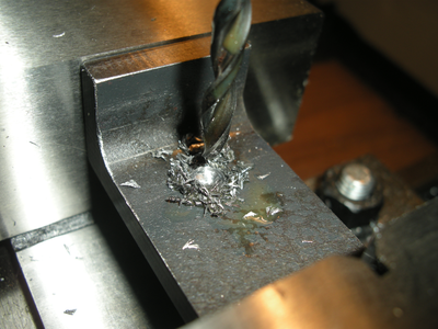

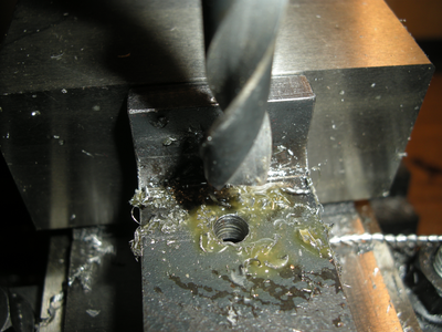

Step 8: Pre-drill the Slot
Drill bits are easier to sharpen than milling cutters, so I drilled holes to hog out most of the metal for the slot. I started with a smallish bit (I think around 1/4 inch) for a pilot hole, then opened it up to 3/8 inch. I know the drawing shows a 0.500 inch slot, but 3/8 inch plus a little is fine.
When I was done there were three 3/8 inch holes through the middle of the clamp, with their sides just touching.
Step 9: Finish the Slot
Next I used a 3/8 inch milling cutter to turn the row of holes into an actual slot. With the spindle running, I lowered the (center-cutting) cutter down into the existing hole at one end of the slot, then moved it to the hole at the other end. I went back and forth in the slot, going down about 0.050 inch or so for each pass, until I was all the way through.
Then I widened the slot by about 0.050 or so by moving the milling cutter in a sort of spiral, cutting the full wall of the slot with a depth of cut of about 0.010 inch. I cut the spiral clockwise, to ensure that I was always conventional milling.
(Note: For the pics in this step I'm showing a clamp where I tried a shorter slot with just two holes pre-drilled. It's working fine, though I think I prefer the longer slot.)

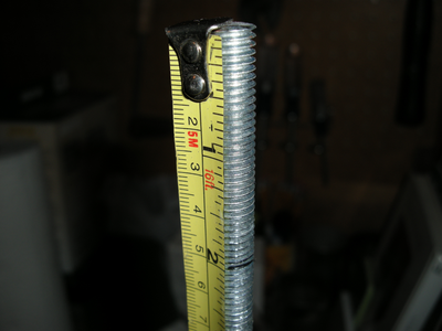

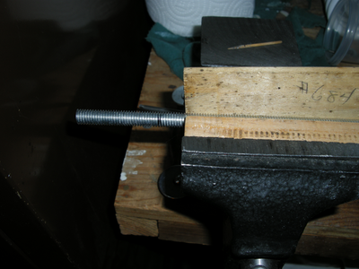

Step 10: Cut the Threaded Rod

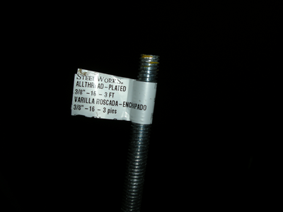

I bought some 3/8"-16 tpi threaded rod from ye olde hardware store. It was cheap and it came with three pies.
I cut it to length with the hacksaw and cleaned up the cut edges with a file.

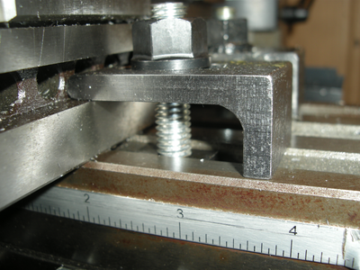

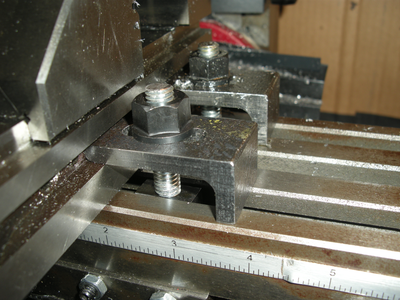

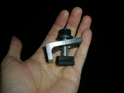

Step 11: Done!
It looks good!
